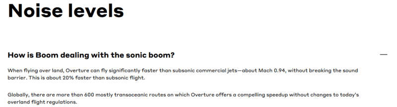

https://boomsupersonic.com/
Hmm, it may be that they still generate sonic booms when supersonic, but are aiming to fly just under mach 1 over land and accelerate to supersonic over water...
https://boomsupersonic.com/faq
