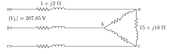

S= 3VaIa*
After transformation:

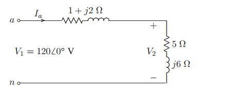

Ia = 120<0 / (6+8j) = 12<-53.13 A
Total complex power = 3 * Va * Ia* = 3*120<0 * 12<53.13 = 2592W + j3456 VAR
This is the power supplied from source. What would be the power consumed by load?
You know the load impedance and load current. How will you determine the active and reactive power associated with the load?
Load impedance = 5 + j6
Load current = 12<-53.13A
I*I*Z
I*I*Z
Yes. Take magnitudes only.
S=I2Z.
S=I2Z.
So 144 * (5+j6)
power of (1+j2)= 144 * (1+2j)
and
(load) = 144*(5+j6)
combined become 864W + j1152VAR
but the total complex power is 2592W + j3456VAR
Is it right for these values to not match?
eehelp150 said:
So 144 * (5+j6)
Yes.
Yes. Can you say why?
cnh1995 said:
Yes.
Is it because it's 1/3 of the "actual" circuit?
Do I need to multiply by 3 to get the total complex power consumed by load?
If no, does this look correct?
720W + j864VAR
Load power factor:
S = sqrt(Q^2+P^2) = 1124VA
PF = P/S = 720/1124 = 0.64 lagging (Q>0)
correct?
720W + j864VAR
Load power factor:
correct?
Well, you calculated the total power for three phases. So, you should multiply the load power by 3. But they are not equal because out of total input power, some power is associated with the line impedance 1+j2 ohm. Remaining power is fed to the load.

You should multiply by 3. You have transformed the circuit into its per phase equivalent. Total power will be thrice the per phase power.

Here, while applying S=I2Z, you should consider the magnitude only. If you want to use the phasor form, you should take the conjugate of the current i.e. (IZ)(I*).
