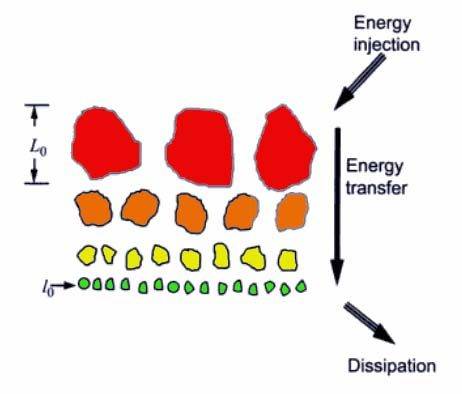

Yes, so smaller and smaller eddies are created. But my point originally is this:
The sources say that supply rate is proportional to dissipation rate. Yet, if you look at this diagram, a typical diagram you see energy cascades, the large eddies, in red, have a turn over time of L/u. So they will take, let's say, ten seconds to transfer their energy to the next scale which is in orange. Another ten seconds will then pass til the energy reaches the smaller scale denoted by yellow. Now eventually, we reach the smallest scale. There are 15 small eddies, denoted green. Assume they are the same size such that their turn over times are all the same, let's say l_small/u_small. So they have a life-time which is considerably less than the large eddies. 1/ Time = Rate. So if lifetime goes down, rate must go up.Now, if just those 15 eddies are sufficient to dissipate the energy that the red eddies transferred to them, the dissipation rate cannot equal the supply rate since those small eddies will have dissipated all the energy by the time their life time is up which, by definition (and I believe through experiment), be shorter than the time period the large eddies. The only way the dissipation rate can be equivalent is if:
a) The yellow eddies, upon a second turn over time, create another stage of green eddies which are further required to dissipate the original energy from the large scale etc.
b) An even smaller scale is created which seems unlikely because viscosity will immediately prevent this (assume the red scale is the smallest possible scale in this flow).
So on one hand they say that the turn over time of these eddies are small and they have diagrams showing that a few large eddies create many many small eddies, yet they still suggest that the RATE of supply remains proportional to RATE of dissipation, even though the TIME (or DURATION) of dissipation will go down because we are summing the dissipation of all the eddies in that stage that were originally created from the large red eddies, hence the dissipation RATE must go up, hence it cannot equal the supply rate?
I'm not suggesting that the theory is wrong, I just don't understand what it is I'm missing here.

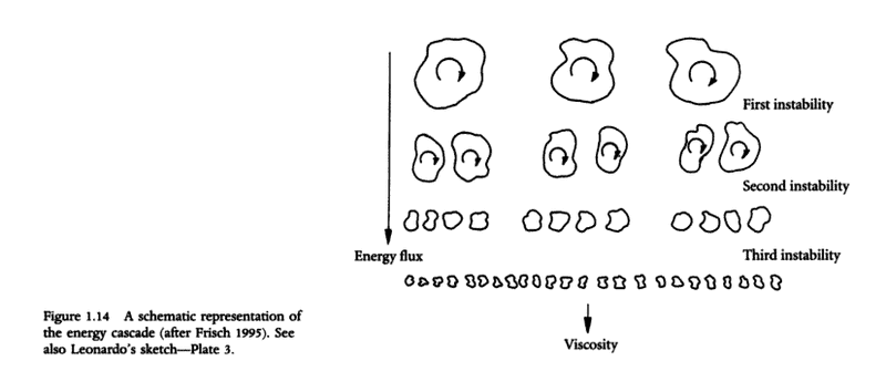

The energy transfer rate at a given scale, ##\ell##, is ##\mathscr{T}(\ell) = u(\ell)^2/\tau(\ell)##. If you take a look in a source like https://www.amazon.com/dp/0521598869/?tag=pfamazon01-20, you can see that ##u(\ell) = (\varepsilon\ell)^{1/3} \sim u_0(\ell/\ell_0)^{1/3}## and ##\tau(\ell) = (\ell^2/\varepsilon)^{1/3} \sim \tau_0(\ell/\ell_0)^{2/3}##, where ##_0## quantities are taken at the very large, energy containing scales. From there you can show that ##\varepsilon = \mathscr{T}(\ell) = u(\ell)^2/\tau(\ell)##, and using those relations in terms of ##\ell/\ell_0##, you can see that the ##\ell##-dependence drops out and you are just left with ##\mathscr{T}(\ell_0) = \varepsilon##.

Nothing says all of those small eddies are generated simultaneously or sequentially. In reality, it would be a constant process of small eddies being formed and dying such that the dissipation rate is consistent with the rate at which energy is being supplied.
Those simple figures are great for getting a visual, but it isn't as if each eddy simultaneously breaks up into two more smaller eddies as it would appear in the image. The energy cascades a constant, poorly-understood process. However, predictions made using these hypotheses have been tested experimentally and found to be accurate.
So if someone were to ask me, is it fair to respond and say we still don't really know exactly how, at each stage, the forming and dying process of these smaller eddies occur to allow for the dissipation and supply rate to be consistent? And secondly, to sum up, can we also just say that what we have is the Richardson cascade, a phenomenological description which describes a general overview of energy dissipation in turbulence, and Kolmogorov's theory quantifying the small scales at which dissipation occurs, but the details at each stage are still, as you put "poorly understood"?
That's probably mostly fair. I seem to recall Pope saying pretty much exactly what I said in his book: basically that the precise mechanism/morphology of the energy cascade is fairly poorly understood but that the predictions based on that theory have been borne out experimentally with regularity. That was written in 2005-ish, I believe, but I've not come across anything contradicting it yet.
