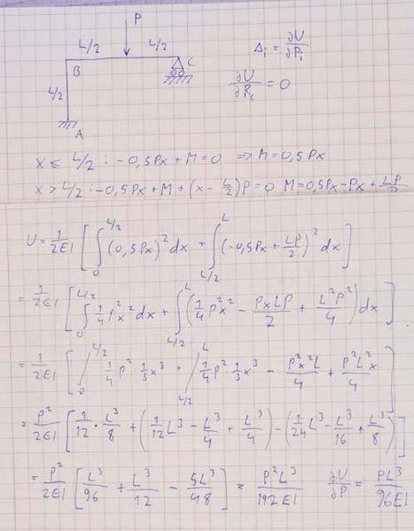

Determine the support reactions for the given structure(see attachment) due to flexural deformations using castigliano's second theorem. Axial deformations are considered negilible.
delta = dU / dP
See attachment. I could use some advice on how to continue. Thanks.

in such questions u don't have to differentiate with respect to force...do it with respect to displacement...n then by using relations replace it with the support reactions..
It would help if you didn't assume that the Right hand reaction was P/2. It is less than that because the encastre support at A attracts load to it, this being a statically indeterminate structure. Have you obtained all the reactions and checked external equilibrium before starting all those integrals?
