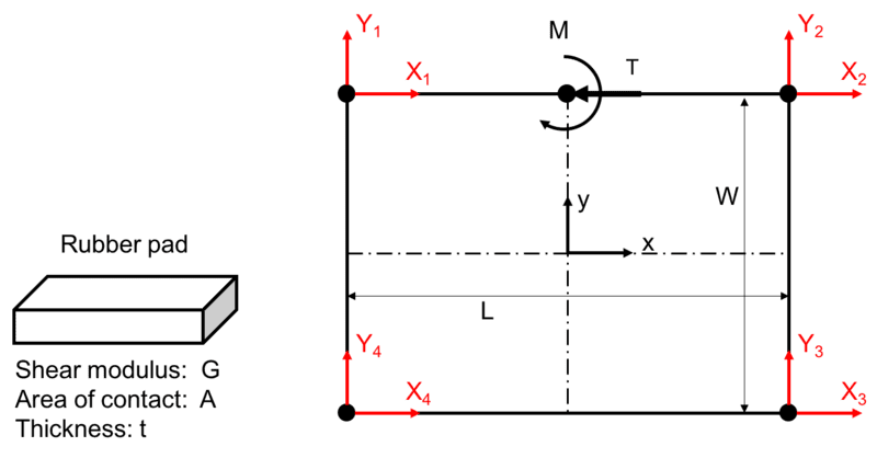

In summary, the problem is to find the equilibrium equations for a rigid steel frame that sits on rubber pads and is subjected to a shear force and moment at some point on the frame. All the known variables are shown in black, while the unknown are in red. It is a two-dimensional problem.
InYoung
Solve for support reactions of a rigid, rectangular steel frame sitting on rubber pads at the four corners (See attached), when a shear force and a moment is applied at some point on the frame. All the known variables are shown in black while the unknown are in red. It is a two-dimensional problem.
Force balances : Sum of X = T & Sum of Y = 0
Moment balance about point 1 (upper left hand corner) : (X3+X4)W + (Y2+Y3)L - M = 0
There are eight unknown reaction forces and three equilibrium equations. It seems like a statically indeterminate structure to the degree of 5 (8 unknowns - 3 equations). Could anyone offer help on how to find the appropriate compatibility equations? Thank you!
The four pads will deform, and they are identical.
Each extent of deformation relates to the shear force.
What can you say about the relationships between the different extents of deformation?

Umm, can I say that the x-direction deformation of pad #1 and that of pad #2 have to be the same given that the steel frame is rigid? Also for pads #3 and 4. As for the y-direction deformations would be equal for pads 1 and 4 (and for pads 2 and 3). Are these correct assumptions to make?

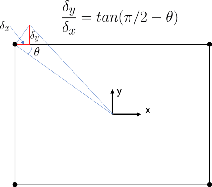

Work in terms of the displacement of the frame. If its centre is displaced (Δx, Δy), and its orientation displaced Δθ, you can compute all the deformations from those.
So for a general frame displacement, if I look at the pure rotational deformations, these would be due to the differences in the shear forces (Y2 - Y1) and (X2 - X1). These deformations would be 'constrained' by the given geometry of the frame, as shown in the attached photo. (Again assuming small displacements). Is this correct?
Yes.
Relate tan theta to the given dimensions of the frame.
You can represent the whole movement of the frame as a rotational displacement, plus an x displacement, plus a y displacement.
