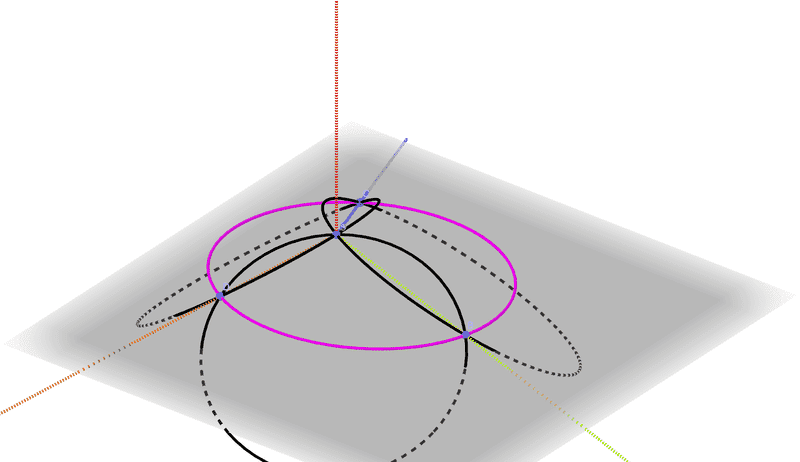

I do not agree with the statement that the sphere's center will be at the center of the triangle ABC. You forgot about the point ##O## in which the four rays originate. If you decrease ##d## to ##0## I.e. you move one of the points inward as far as possible, the points ##O## and ##D## coincide. However, ##O## is not at the center of the triangle ##ABC##.
I have tried to visualize this in GeoGebra. However, this is cumbersome as I cannot construct a sphere from four points in GeoGebra. As a workaround I have constructed four circles instead.
The red ray (top) has the point ##A##, the orange (left front) has the point ##B##, the green ray (right front) has the point ##C## and the blue ray (in the back) has the point ##D##.
In the picture below I have moved the point ##A## all the way down so ##AO=0##. I think you can see that the pink circle going through the points ##BCD## is not a great circle.
You can take a look at the original GeoGebra file here https://www.geogebra.org/classic/fdjwwpy7
I found, that the strange angle between the axes and the use of four axes makes this problem very counterintuitive.
I think I have to reformulate my problem...

I did not suggest that you decreased ##d## to ##0##, and I did not suggest that ##O## would be at the center of the triangle ##ABC##: it is obvious that O, A, B and C are fixed and O is not in the same plane as triangle ABC so cannot be its centroid. The centre of the sphere is only at ## O ## when ## { a, b, c, d } ## are equal.
What I said was if you decrease ## d ## until A, B and C lie on a great circle then the centre of the sphere lies at the centroid of triangle ABC.
So don't move it down that far, only move it as far as you need to so it is a great circle.
