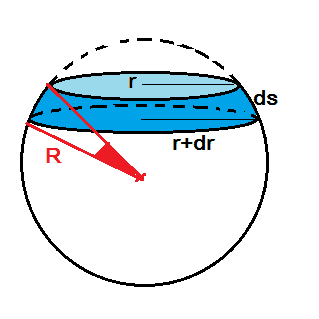

To get the surface of the sphere, we slice it as shown in the figure, and approximate that shape with a truncated cone, the piece of the surface of the sphere with the area of the side of that truncated cone.
Perhaps it would be beneficial if you attempted to derive the expression using polar coordinates instead, it should be pretty straight-forward figure out what ##ds## is by looking at ehild's diagram.

Nice picture. What package did you use do draw/upload it?

I use Paint, included in Windows. And I just do Upload. Or I copy the picture and paste into the post.
