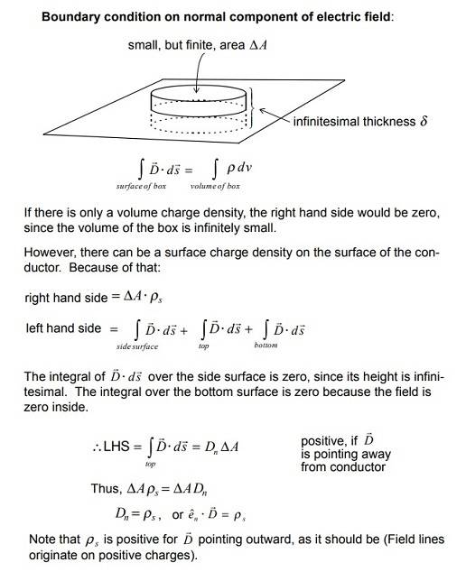

Equation σ = ϵ0 * E applies to conductive surfaces, regardless of their shapes
Likes Samanko
