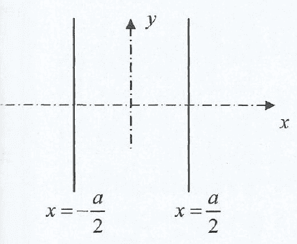

Given the following drawing, two infinite sheets (in y and z axis) of ideal conductive material. their thickness is infinitesimal (dx->0).

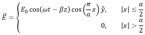

The electric field is defined:
I have askes to find the surface charge and current density.
well.. I tried to apply the integral gauss law
but in 2 dimensions (didn't work).
I have also tries the derivative version of the law
which gave me zero. it looks right for me, since the electric field should be perpendicular to the surface. but the only electric field is parallel to the surfaces. Then where this field is come from?? I'm very confused..

Have you considered that this could be the electric field of a propagating electromagnetic wave?
