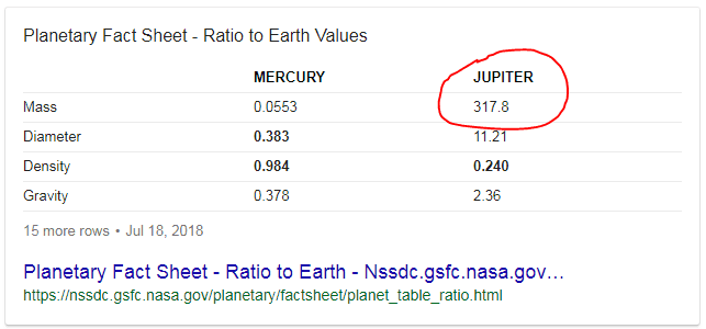

Edit:
Also, the ratio of Jupiter to Earth mass is more like 318:
But your point is taken, and the Hill Sphere is a great way to look at the relative volume of space that planets can use to hold onto satellites.
