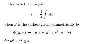

I'm having trouble evaluating this surface integral. This would be very simple to solve if the parameter domain of the variables u and u was a square region. However, that isn't the case here. I've tried using a change of variables and saying that u = r cos x, and v = r sin x. Where 0 < x < 2pi, and 0 < r < 2 for the limits of integration. However, computing the surface differential (absolute value of the cross product of the partial derivatives) using the new variables has become way to complicating and tedious. I end up with about 6 or 7 terms of sines and cosines under a square root that cannot be simplified. Was this the way to approach this problem? I also thought about parametrizing the region R, but I'm not sure how that would work.Also, since I'm already here, how would I be able to do this for some general region R in the u-v plane? This is what lead me to think of a parametrization of a region R. So basically a parametrization within a parametrization. Mhmm, sounds interesting. Is that possible?

Given parametric equations for a surface, x= f(u, v), y= g(u, v), there are two ways of handling surface integrals. One is just to use the formula [itex]dxdy= \frac{\partial x, y}{\partial u,v} dudv[/itex] where [itex]\frac{\partial x,y}{\partial u, v}[/itex] is the Jacobian,
[tex]\left|\begin{array}{cc}\frac{\partial x}{\partial u} & \frac{\partial y}{\partial u} \\ \frac{\partial x}{\partial v} & \frac{\partial y}{\partial v}\end{array}\right|[/tex].
More fundamentally, you need the "algebra of differential forms" which is anti-symmetric (to really understand why requires a course in "differential geometry" and "differential forms").
If x= f(u,v) then [itex]dx= f_u du+ f_v dv[/itex]. If y= g(u. v) then [itex]dy= g_u du+ g_v dv[/itex].
Multiplying, [itex]dxdy= (f_u)(g_u)(du)(du)+ (f_u)(g_v)(du)(dv)+ (f_v)(g_u)(dv)(du)+ (f_v)(g_v)(dv)(dv)[/itex]. Since multiplication of differential forms is anti-symmetric, (du)(du)= (dv)(dv)= 0 and (dv)(du)= -(du)(dv) so that reduces to [itex]dxd7= (f_ug_v- g_vf_u)dudv[/itex] as given by the Jacobian.
Here's the problem in a latex form:
$$I = \frac{1}{4} \iint_S dS$$
You are given the surface ##\vec \phi(u,v) = <u+v, u^2 + v^2, u-v>## with ##u^2 + v^2 \leq 4##.
For the surface integral of a scalar function, ##dS = ||\vec \phi_u \times \vec \phi_v|| \space dA## or ##dS = \sqrt{z_u^2 + z_v^2 + 1} \space dA##.
The first form of ##dS## seems more appropriate as you are given ##\vec \phi##. So:
$$I = \frac{1}{4} \iint_S dS = \frac{1}{4} \iint_D ||\vec \phi_u \times \vec \phi_v|| \space dA$$
Simply switching to polar co-ordinates from here gives your limits for ##r## and ##\theta##. Then:
$$I = \frac{1}{4} \iint_S dS = \frac{1}{4} \iint_D ||\vec \phi_u \times \vec \phi_v|| \space dA = \frac{1}{4} \iint_{D'} ||\vec \phi_{u=rcos(\theta)} \times \vec \phi_{v=rsin(\theta)}|| \space rdrd\theta$$
