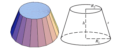

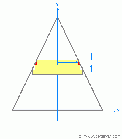

If i want to calculate the volume of a cone i can integrate infinitesimal disks on the height h of the cone.
I was told that if i want to calculate the surface of the cone, this approximation is not correct and i have to take the slanting into account, this means that instead of infinitesimal disk i have to consider infinitesimal conical frustum and integrate the lateral surface of each infinitesimal conical frustum. Why for the surface i can't use infinitesimal disks as for the volume calculation ?
Furthermore, the formula for the lateral surface of a conical frustum is :
Now, let's consider an infinitesimal conical frustum.
For [itex]h\rightarrow 0[/itex] , [itex]R_{1}\approx R_{2}[/itex] so [itex](R_{1} - R_{2})^{2} \rightarrow 0[/itex] and the surface of an infinitesimal conical frustum would be[itex]2\pi R_{2}\,dh[/itex], however i was told that it's not correct. The correct one is [itex]2\pi R_{2}\sqrt{ d(R_{2}-R_{1})^{2}+ dh^2}[/itex], why?

It's an interesting question of how you know when these estimates are correct. Let's look at the two cases of the volume and the area. If we look at the volume, we can see that:
$$\pi R_1^2 h < V < \pi R_2^2 h$$
If we now imagine an infinitesimal frustrum of height ##dh##, we see that:
$$\pi r^2 dh < dV < \pi (r + dr)^2 dh = \pi (r^2 +2rdr + dr^2)dh$$
And, as we can neglect higher order terms, this gives us a valid equation for the infinitesimal volume element:
$$dV = \pi r^2 dh$$
When we look at the area, however, we see that:
$$2\pi R_2 s < A < 2\pi R_1 s$$
And, for an infinitesimal frustrum:
$$2\pi r s < A < 2\pi (r+dr)s$$
And, we can see that:
$$s = \frac l h dh$$
Where ##l## is the slant height of the full cone.
This gives us the equation for the infinitesimal surface area element:
$$dA = 2\pi r \frac l h dh = \frac{2\pi l}{R}rdr$$
The moral is that you really have to ensure that your estimates are valid to the first order in the infinitesimals.

For the frustrum, you can do:
$$dA = 2\pi r dl$$
And, with ##L## as the slant length of the fulcrum, we have:
$$dl = \frac{L}{R_2 - R_1}dr$$
This gives:
$$A = \int_{R_1}^{R_2} \frac{2\pi L}{R_2 - R_1} r dr = \frac{\pi L}{R_2 - R_1}(R_2^2 - R_1^2) = \pi L (R_1 + R_2)$$
And, in terms of ##h##:
$$A = \pi (R_1 + R_2)L = \pi(R_1 + R_2)\sqrt{(R_2-R_1)^2 + h^2}$$
Finally, this makes sense as:
$$A = 2 \pi R_{avg} L$$

themagiciant95 said:
Yes but i don't understand the rules when dealing with infinitesimal quantities. It's the only thing i can't deeply understand in ungraduate physics and i haven't found a book about it.
ps: i think i have not understood why you have took care of this chain of disequalities: [itex]\pi r^2 dh < dV < \pi (r + dr)^2 dh = \pi (r^2 +2rdr + dr^2)dh[/itex] . For what purpose ?
That was to check that the equation ##dV = \pi r^2 dh## is valid to first order.
Whereas, you have:
the surface of an infinitesimal conical frustum would be [itex] 2\pi R_{2}\,dh[/itex],
But, the width of the area element is ##ds##, which is not equal to ##dh## to first order. Instead, we have:
$$ds = \frac L R dr$$
Where ##L## and ##R## are the slant height and maximum radius of the full cone.
