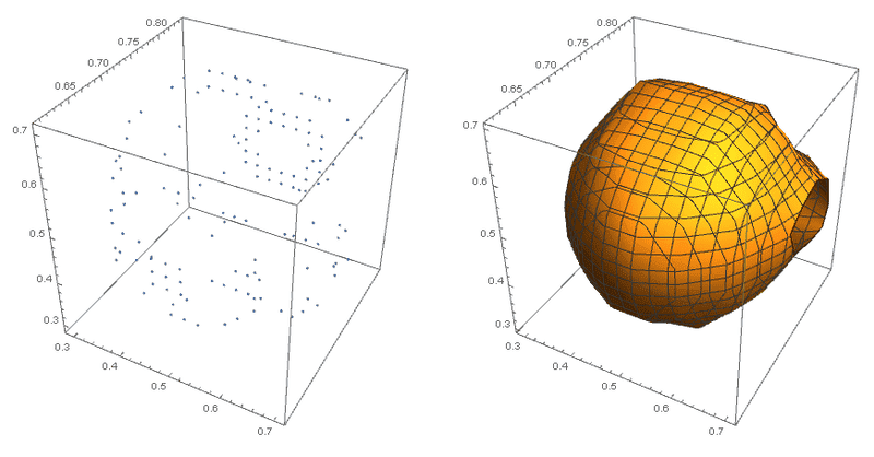

Hi there. I wanted to plot a surface, given implicitly by a function ##f(x,y,z)=c##, with ##c## a constant. My ##f(x,y,z)## is obtained numerically, so I don't know the expression explicitly, I have the values of ##f(x_i,y_j,z_k)## for given integer numbers ##(i,j,k)##, ##i=1,2,3...## same for ##j## and ##k##. And the discrete variables are ##x_i=(i-1)\Delta x## and similarly for ##y_j,z_k##.
So, in principle I can obtain, numerically a set of data for which ##f(x_i,y_j,z_k)=c##, where the ##x_i,y_j,z_k## are stored, and I know c (I just choose the value I want). And now I know that for those values, the magnitude of ##f(x,y,z)=c##, so this defines a 3D surface. Now, how can I plot this? it should be clear at this point that f might not define explicitly a function, it might not be bijective, it is likely to be a closed surface, like a spherical surface in 3D.

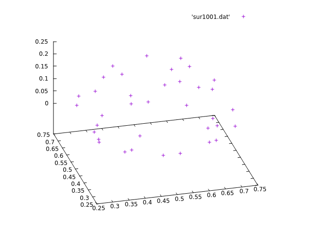

Ok. So here I have a set of data which I want to plot. I have also attached a plot of the data:
So, as there are not many points, I really have to use some interpolation to get a descent picture. However, I don't think that even after the interpolation I will be able to plot it as a surface, I haven't found how to do it, but maybe if I have more points after interpolation, I can make it look more descent.
I was thinking to take pairs of points: (x,y), (x,z), (y,z) and make an interpolation for each pair. After that I can collect the whole bunch of data intro a single file back again, and plot it just like that. The idea is to have interpolations over the three planes.
  • sur1001.txt
Very easy in Mathematica. Here's the code to collect points {x,y,sin(x y)} in range (-2,2) and then I superimpose the actual plot (red) against the interpolation (blue):
Code:
p1 = Plot3D[Sin[x y], {x, -2, 2}, {y, -2, 2}, PlotStyle -> Red];
mySinTable =
  Flatten[Table[{x, y, Sin[x y]}, {x, -2, 2, 0.1}, {y, -1, 1, 0.1}],
   1];
mySinInterpolation = Interpolation[mySinTable];
p2 = Plot3D[mySinInterpolation[x , y], {x, -2, 2}, {y, -2, 2},
   PlotStyle -> Blue];
Show[{p1, p2}]

Can you do that with the data I have provided? I am wondering if the fact that this data isn't a function ##z=f(x,y)## (not bijective) generates any issue in mathematica. If possible the interpolation has to be done in many directions. If you, for example, only interpolate along the fixed z curves, it will look poorly along the z axis, and the same applies for the other planes.
Thanks!
Thanks!
Post the data as a table {{x1,y1,z1},...,{xn,yn,zn}} and I'll try to run it through the code above and see what happens.

Is it okey like this?

That will do. Just paste into myNumList as a string and (basically spherical):
Code:
myList = ReadList[StringToStream[myNumList], Record];
myDataPoints =
  ReadList[StringToStream[#], Record, RecordSeparators -> " "] & /@
   myList;
data2 = ToExpression[#] & /@ myDataPoints;
ListPointPlot3D[data2, BoxRatios -> {1, 1, 1}]
ListSurfacePlot3D[data2, BoxRatios -> {1, 1, 1}]
gives:
Likes Telemachus
