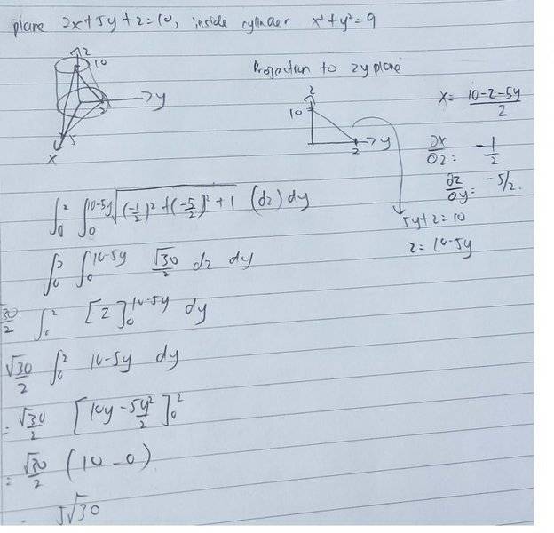

Find the surface portion bounded by plane 2x +5y + z = 10 that lies in cylinder (x^2) +(y^2) = 9 ...
I have skteched out the diagram and my ans is 5sqrt(30) instead of 9sqrt (30) as given by the author ...

@Mark44 , here's my working , i am not sure whether my projection to zy plane is correct or not ...

I have a couple of comments for you. First: your statement of the problem says the area of the plane inside the cylinder, but your picture and working apparently are for only the portion of the surface in the first octant only. Which is it?
Second: The intersection of a plane and a cylinder is typically an ellipse. Why on Earth would you choose the projection on the zy plane? The only projection that would be circular would be on the xy plane. That's where you should project it.
Sorry , i forgot to include other octant ...

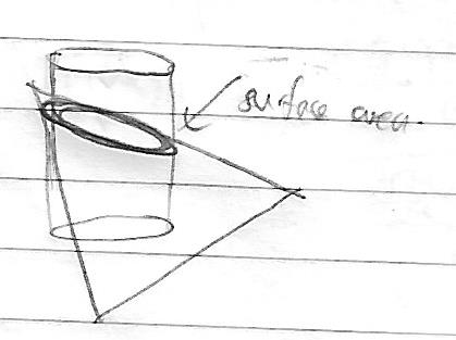

No it isn't. The boundary of a plane cutting through a cylinder at an angle will be curved and, in this case, is an ellipse shape.

why ? can you explain further with the aid of diagram ? I still can't imagine it ...Btw , the plane 2x + 5y + z = 10 only lies in first octant , am i right ?
A plane extends in all directions. Your triangle is just a small portion of a plane. Forget the coordinate system for a minute. Just imagine a cylinder with a plane slicing through it. Here's a picture of one (not your particular one). There aren't any straight lines like you have drawn. Also, although the green is an ellipse, do you see that if you looked at it straight down the z axis it would look like a circle?

Here's what your original problem statement was:
There is nothing about triangles, octants, or straight lines. When planes cut through cylinders at an angle it looks generally like the picture I gave you.

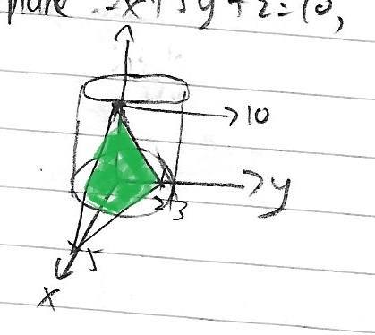

why ? The 2x+5y +z =10 is a triangular plane... The diagram that you sketched look like the volume bounded by tirangular plane 2x+5y +z =10 and cylinder ... But , what we want here is the surface area of plane 2x+5y +z =10 inside cylinder , right ? So , how could the surface area of tirangular plane 2x+5y +z =10 look like a circular plane ?
The diagram that LCKurtz provided shows the surface area (not volume) of the region of a plane inside a cylinder, very similar to what you're trying to find in this problem.
Until you can understand why the diagram that you drew is incorrect, and the one that LCKurtz provided is what you need, you will not be able to do this problem.

if we look at the plane 2x+5y +z =10 only , then it's triangular plane right ?
chetzread said:
if we look at the 2x+5y +z =10 only , then it's triangular plane right ?
No! If you look at only the portion of the plane in the first octant, what you get is a triangle, but the plane extends infinitely far in two dimensions.

well , in the previous example , i can understand that plane z= x +4 lies in the cylinder has the surface area as shown... I just don't understand why that the plane 2x+5y +z = 10 has the shape similar to the case of z= x +4 lies in the cylinder as shown...
IMO , the y -intercept is 2 , which is less than the y-intercept of cylinder , which is 3 , so , how could the surface area formed by 2x+5y +z = 10 inside the cylinder has circular surface ?
The plane doesn't stop at the x-y plane, as you seem to be thinking. The portion of the plane that is inside the circular cylinder has an elliptical shape, a point that has been made multiple times in this thread.
Look at it this way: if the plane were parallel to the x-y plane, the portion of this plane that is inside the cylinder would be circular, right? If you tilt the plane, as 2x + 5y + z = 10 is, the portion of this plane that is inside the cylinder is in the shape of an ellipse.
You're stuck on the idea that you plane has a triangular shape. IT DOESN'T!
