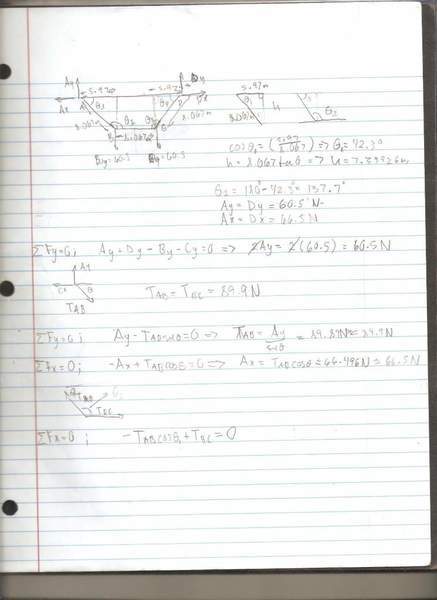

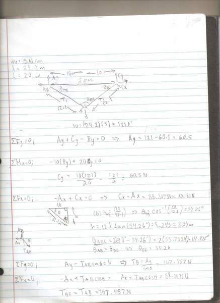

I have done the first permutations from the problem. Where there 2 rods instead of the cable and where there are 3 rods intead of the cable. What i am having problems with is in the third and fourth permutations. I can't figure out how to solve the angles. I am sure if i could find one angle i for both of the last permutations i could finish the rest on my own.
The teacher has stressed that we use the symmetry in the problem but i can't figure out how to do it.
In the part where we use 4 rods i know each rod has a length of 6.05 and there is 3 suspended weights of 40.333. i have tried projecting the 4 rods over the length of 20m to form an octagon but that didnt work. I also thought of using isosceles triangles but didnt know where to go from there. Can someone point me in the right direction?

Your work is upside down.
If the suspended cable were uniform, the shape would be a cosh function (catenary) for which a parabola is a good approximation when the span is (say) greater than 8 times the dip. The nodes of the rigid bar solutions should also lie on a catenary (or parabola).
