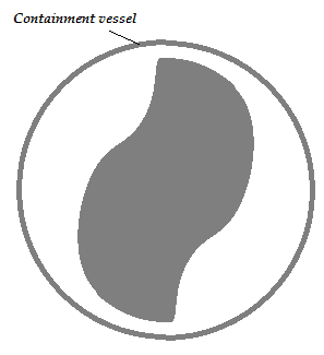

the_wolfman said:
Imagine what would happen if the vortex collapsed. A cylinder with a vortex in the middle has a higher surface area to volume ratio than a cylinder without a vortex. This means that the cylinder is a more favorable configuration for fission. If the vortex collapses, then the neutron multiplication in the reactor will increase. The power level will grow exponentially and the potential for a serious accident is huge!

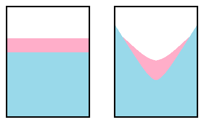

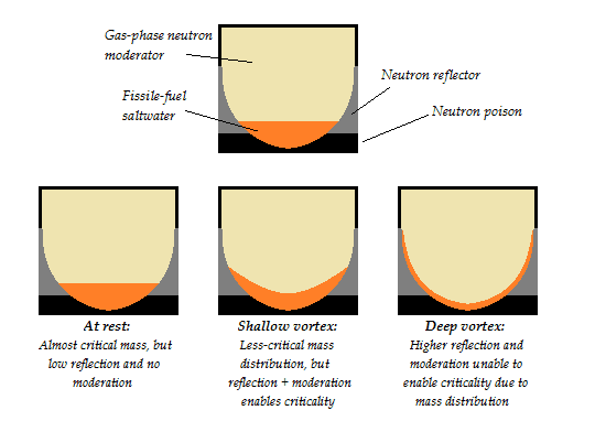

It was my understanding that in the Kelley excursion, criticality was achieved because there were two unmixed layers of fluid. At rest, the surface area of the plutonium-carrying layer was very high, but as the vortex formed, it concentrated the plutonium into the center. The bottom layer of fluid acted as a neutron reflector, and thus prompt criticality was inevitable:
Such a design can be rendered inherently safe because at rest, it is in a lower-criticality state than it is in motion; however, if the vortex becomes too sharp and power output goes too high, the energy release will cause mixing of the two fluids and immediately disperse the fuel.
I'd presume that the design of an intentional nuclear reactor would use some heavy immiscible fluid as the base/reflector fluid. Either that, or use a container with a shape that allows criticality only within a certain range of vortex strengths, perhaps using a neutron reflector that covers only some portion of the container:

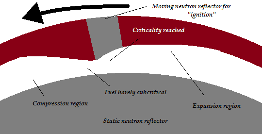

Hmm.
What about something like a rotary ramjet turbogenerator, but using fissile-fuel saltwater as the fuel and a neutron-reflecting ramjet?
The fluid would pass through an impeller that sent it into narrow channels at the base. .The rotating portion would compress the fuel to near-criticality before exposing it to a neutron-reflecting "igniter" which would cause criticality; the heating and expansion of the fuel would push the rotating portion before the fuel passed out of the impeller and into a heat exchanger before being recycled back through.
Direct steam production including the nuclear material: possible, but with many safety issues. Pressurized radioactive gas...
The space version is the nuclear salt-water rocket without turbine.
Indeed, pressurized radioactive gas is something to be avoided on the best of days. Hence the desire for generating a stable, continuous critical reaction inside a fluid vortex, and doing so using some sort of asymmetry so that the energy can accelerate the vortex.
