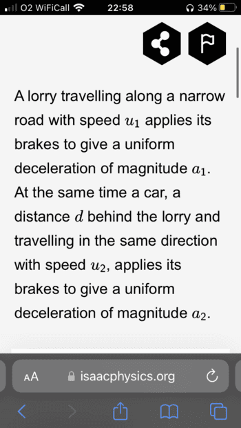

A lorry travelling along a narrow road with speed u1
applies its brakes to give a uniform deceleration of magnitude a1
. At the same time a car, a distance d behind the lorry and travelling in the same direction with speed u2
, applies its brakes to give a uniform deceleration of a2
Part A

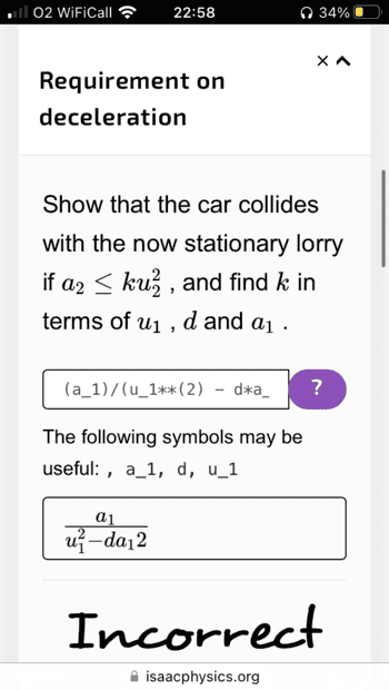

Requirement on deceleration
All questions in this part are answered incorrectly
Show that the car collides with the now stationary lorry if a2≤ku2^2
, and find k in terms of u1 , d and a1

lukegxhycj said:
(a_1)/(u_1**(2) - d*a_1*2)
That's an expression, not an equation. Can you try to show more work on this? I'm not sure why you're having issues typing math into the forum. What kind of phone is it?

Yh this is the answer I got but it’s wrong
K=
Then you need to post your working so that we can see where you went wrong.

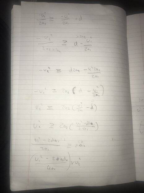

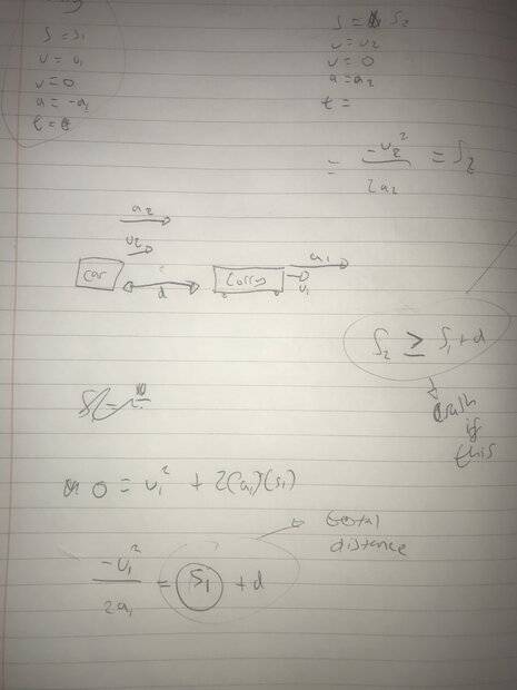

Your photos of your work are almost completely illegible, due to poor lighting and mostly faint writing. We generally discourage members from posting photos of their work for these reasons.

(If distance the car stops is bigger than the distance the lorry stops plus the initial distance then they will crash)
This condition is not relevant. The car can crash into the lorry before the lorry stops.
Yes sir the the question says the lorry stops before the car

I think you have been inconsistent in the signs on the accelerations. I see "a=-a1” but "a=a2".

At top right of your first attachment I see ##a=a_2##.
##a_2## is given as a rate of deceleration, so the acceleration is ##-a_2##. You did it correctly for ##a_1##.
