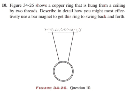

Swinging a hanging copper ring with a bar magnet
In summary, the ring will move back and forth in direction normal to the plane of the page as long as the magnet is moving along the normal direction too and of course inside the area of the ring.
versine
24
Figure 34-26 shows a copper ring that is hung from a ceiling by two threads. Describe in detail how you might most effectively use a bar magnet to get this ring to swing back and forth.
Faraday's law
Force on current carrying wire
I thought of few scenarios and they ended up as follows:
The ring must have an induced current. Due to the symmetry of the ring, if one part of the ring feels a force, the part of the ring radially opposite this part will feel a force opposite in direction, since the current will be opposite in direction relative to the magnetic field. So they will either cancel out or cause the ring to spin, even if the magnetic field is moved to one side, making one side stronger.
Likes Delta2 and Shreya
No, the ring will not spin, in my opinion it will move back and forth (that is in direction normal to the plane of the page) as long as the magnet is moving along the normal direction too and of course inside the area of the ring.
Likes versine
In that case won't everything cancel?
The magnetic field from a bar magnet isn't exactly as you put it in that picture. It has a component like this (a z- component) but it also has x and y components (xy is the plane of the page). It is the force due to the x and y components that will make the current loop swing back and forth.
Likes versine
Thanks, makes sense
Likes Delta2
I wonder if you get a better swinging motion of the ring if you move the bar magnet left to right and back across the face of it, or if you push the magnet in and out of the ring in the direction normal to the page...

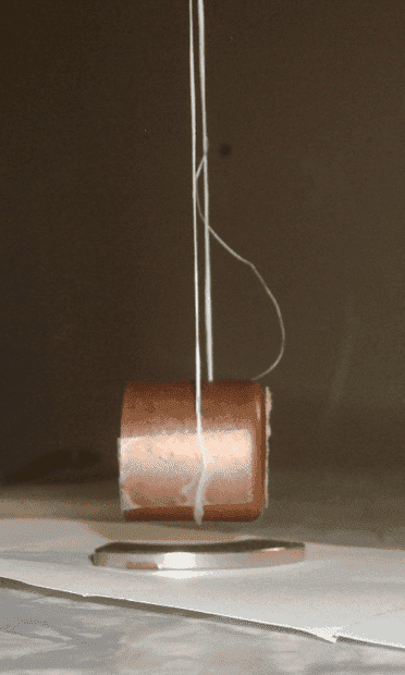

All I could find is a piece of copper plumbing and a hard drive magnet.
