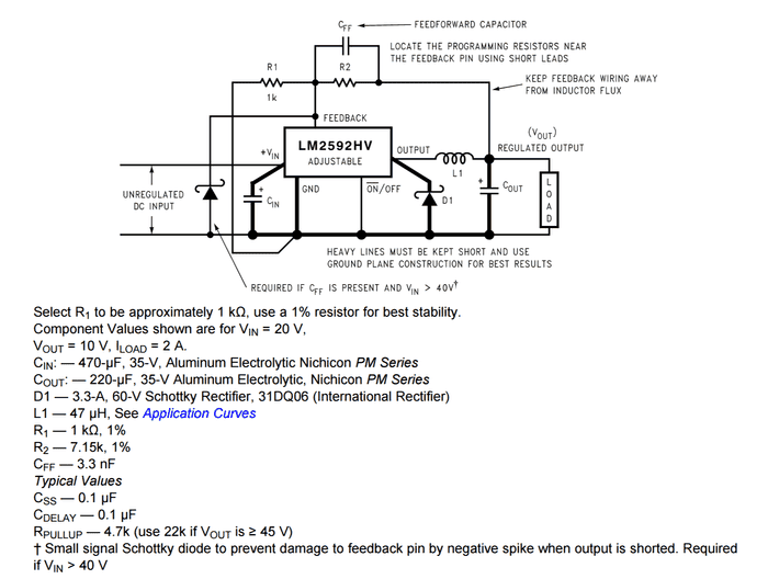

I am working on a switch mode psu in step down configuration with the key components being:
LM2592 (adj) http://www.ti.com/lit/ds/symlink/lm2592hv.pdf
530-PC-24-1000 http://www.mouser.com/ds/2/643/PC-594199.pdf
GSIB-25 http://www.vishay.com/docs/88646/gsib25xx.pdf
Using a slightly modified version of the example circuit where:
R2 = 23.82 KOhm
L1 = 100 mH
The diode on the left is not included but CFF is included as vin does not exceed 40vdc.
I am using /HALF/ of the transformer and ending up with 20vdc at the output of the rectifier. (reading into this, it appears higher loads and adjustments of the filter capacitor should drop this down closer to 12vdc.) initially with both windings of the transformer attached, the rectifier was outputting a stunning ~40 vdc.
^this is not my issue however... (at least i don't think)
At the moment the power supply is outputting ~18.6 vdc... (to a 5watt load of LEDs)
With Vin reading 19.5 vdc and feedback to ground reading 0.75 vdc.
I am not sure why i am getting practically no step-down?
Adjusting R2 seems to have minimal affect on the output voltage.
It's also important to note that the LM2592 produces little to no heat... slightly disturbing..
Does anyone have a clue of some methods to troubleshoot this issue?

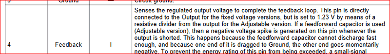

From that datasheet:
Feedback pin 4 wants 1.23 volts and is getting but 0.75, you say ? Good troubleshooting !
It'll stay saturated trying to raise feedback pin to 1.23 volts. So no stepdown and no heat. I like your powers of observation.
R2 = 23.82 KOhm
L1 = 100 mH
What's R1 ? 1K as in drawing ?
Could it be as simple as:
1.23 = Vout X R1 / (R1+R2) = Vout / 24.82
to get 1.23 volts from a voltage divider of 1K and 23.8K will require 30.5 volts at output ?
Try adjusting ratio of R2/R1 to around (10/1.23) -1 ?

Jim, you are 100% correct!
I had put the incorrect voltage divider in!

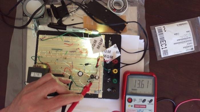

Thank you so much for your help (and to everyone else who commented.)
R1 was 1K, I changed R2 to 10k to achieve roughly 13vdc (my end goal) and everything is working perfectly now.
I have included a picture for those who were interested.
