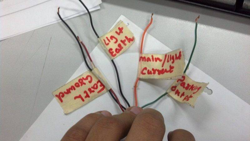

I have two sort of switch one is 5 pin (push type) switch and the other is 2 pin (on/off) type switch for my vehicle.
Can I use first one instead of On/Off switch. In continuation, If I have two wires on which any of mentioned switch is to be applied, then How can I use 5 pin switch on that wire..?
Also what is the function of 5 pins at connector side of switches..?

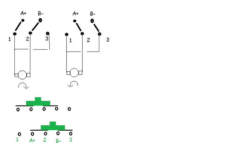

If the switch ratings (V & A) are suitable, then yes. There must be two pins out of the 5 that perform simple on/off.
I would guess the 5 pin is a changeover switch.
Something like A-1, B-2, changing to A-2, B-3, so that with 1and 3 joined you get either A-1&3, B-2 or A-2 , B-1&3.
There could be other possibilities, but there will always be a pair that you can use for on/off.

The first thing that comes to mind when talking about a 5 pin automotive switch is a power window or power lock switch.
Updating my diagram with a centre off position, in light of Av.sup.nov's post.
Oh. Fair enough. I don't know a lot about car wiring principles, though I'd have guessed the reverse - that motors, lights, etc were always connected to ground and the live was routed through switches.
I'd thought originally about a reversing switch in general and only realized the need for a centre off position when you mentioned the window. All I knew was that my switches are 3 position sprung rockers biased to centre off. I've no idea if they are 5 pin nor what their connections are. In fact I think they are simply sending logic signals to the control unit which switches the windows with some sort of H drive. Pressing 'up' can both start and stop upward motion for example. I wouldn't even be surprised these days, if the switching is done by a chip on the motor responding to a CAN bus message.
In order for us to tell you how to connect the 5 pin switch to do the same function as the 2 pin switch, we need to know the internal wiring/contact connections inside the 5 pin switch, and the ratings of the switches and what voltage/current you are switching.
There are many different types of 5 contact switches, and many ways for them the be wired internally. There is no standard way. It could even be a switch with an indicator light on two of the connections. There is no way for us to tell.
Maybe a photo will help. Are there any part numbers on the switch?
Thanks for your replies.
I have done with a physical experiment. and that switch was actually for fog lamp, having 2 lights within switch (one to be light up as parking lights are on and the other when switch is turned on). you may check the picture for sample
I have found a solution that I have grounded three wires and for the rest of two, one is connected to power supply (coming from battery) and second with power coming from Parking (or might be parking relay output). I haven't applied it on vehicle but just check it using battery and it works for me.. you may check the second picture.
