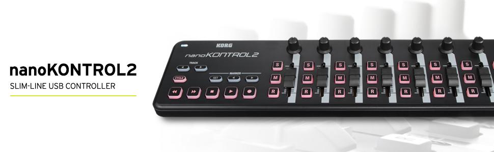

A) Korg NanoKontrol2 - This is a USB device designed for digital musical instruments using the MIDI protocol (over USB). MIDI has been adopted for many general purpose tasks. It is about 3.5” x 13”, and has 8 faders (linear/slide pots) with three momentary buttons/LEDs for each slider, 8 pots, and a few more 'transport' buttons. The ID# and value for each control can be configured and stored. It is very flexible, there are a few similar products on the market.
https://www.amazon.com/dp/B004M8UZS8/?tag=pfamazon01-20
PROS: Lots of controls! Nice looking, relatively cheap considering power (~ $75), and can easily be re-purposed, re-configured. Powered by the USB.
CONS: Too expensive for small projects. Requires a USB host, so not for a discrete design, and I'm not aware of any cheap/reliable USB Host capability on Arduino, I think you need Raspberry Pi minimum? I wish they left space and a removable cover to easily label the controls. Though it's small enough that you could print a legend and attach it above/below the controls and it wouldn't be too bad.Focusing more on Arduino projects, I've found some promising things, some very cheap, but none that I'm all that happy with. I haven't tried these yet, just investigating. On the positive side:

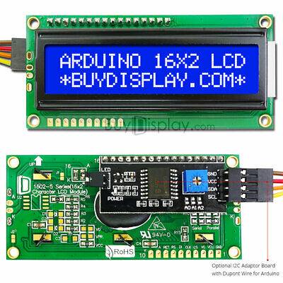

B) LCD multi-line Displays: For small projects where you might just want to get a few words of prompts/status, I'm impressed with the 2 Line x 16 Char, and 4x20 LCD displays. These can be found with I2C interface, using only two I/O pins from your controller (pins are often at a premium on these Arduino boards). And multiple I2C devices can be added to those same 2 pins by address selection jumpers on the device.
Search “I2C 16X2 Character LCD Arduino” will bring them up shipped to US for ~ $5 or less (ebay or ali-express), and the 4Lx20 for a few bucks more. Make sure they include the I2C board, it is an add-on to the LCD.

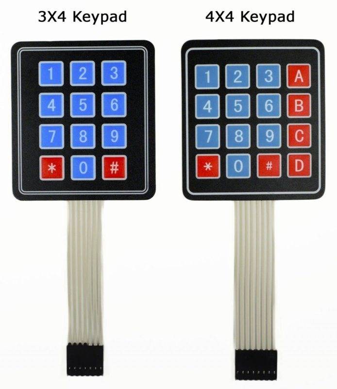

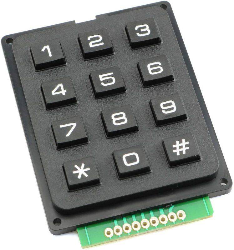

C) Switches/Pots w/LED feedback: I'm not finding much here, and what I've found has bare switches that would take some work to get packaged up in a decent looking project. Since the Arduino world is mostly hobbyists, I'm surprised they don't offer nice cases and knobs for sale, to make a few extra bucks on this low margin stuff. What I'd like is maybe some modules of 4 slider/pots/switches/LEDs like that NanoKontrol2 above, but just bare I2C interface, with optional front panel/case. Combine them as needed for a larger project.This one is interesting, it's not I2C, but uses three pins and there are libraries. Eight switches, eight LEDS, and eight 7-segment displays. It can detect simultaneous keypresses., and just ~ $2 each
That's actually quite suitable for one project I'm considering, but as I mentioned, getting a case and some sort of switch cover together might take some effort.D) Resistive touch screens (w/o display): I was intrigued by these. Pretty cheap and easy to interface to, 4 pins switched to source/measure the X/Y. And this adapter converts it to I2C:

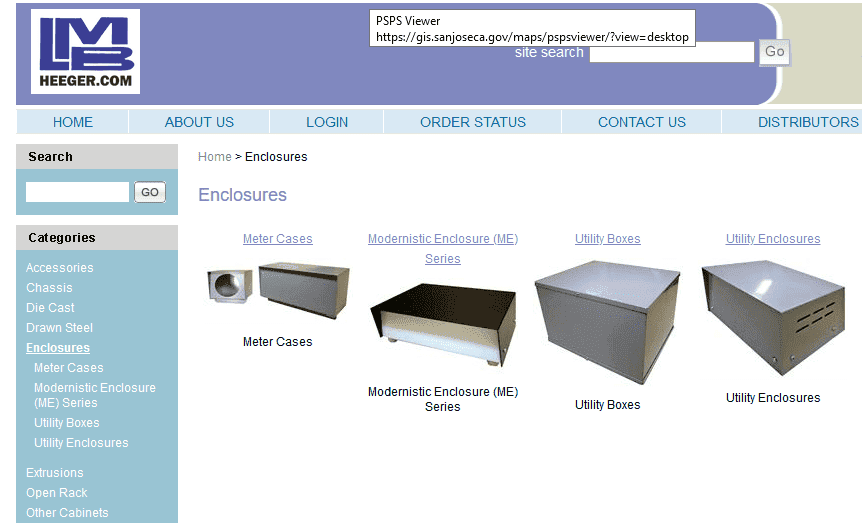

Check out Crystalfontz. More spendy but good stuff. I've used them. Graphics displays and such. Google them. Storm interface makes some tough keypads for data input. Have any ideas for enclosures?
Likes chemisttree and berkeman
I've been happy with Pactec enclosures. They have a wide variety, including some hand-held size boxes that include built-in 9V battery compartments. They also offer semi-custom design services that I've used for small-volume pre-production runs:
https://www.pactecenclosures.com/
I've also used LMB enclosures for more industrial-strength fixtures, like we use in our Manufacturing Test area at work:
https://lmbheeger.com/enclosures.aspx

Then the LCDs came in. Wow, for just a ~$4~$5, these are a big step up from the 7 seg (though smaller characters), with full 5x9 x character support. These have I2C interfaces, so you can connect multiple devices on just 2 pins (each device needs a unique address, most devices come with an offset base address depending on the type, with 3 jumpers to select 0~7 addresses higher than the base). Also an easy to use library in the Arduino IDE.
But no switches - but I found these I2C 16 I/O boards ( MCP23017) for ~ $2 each, so those are easy to connect to the I2C pins, and connect switches/LEDs to.

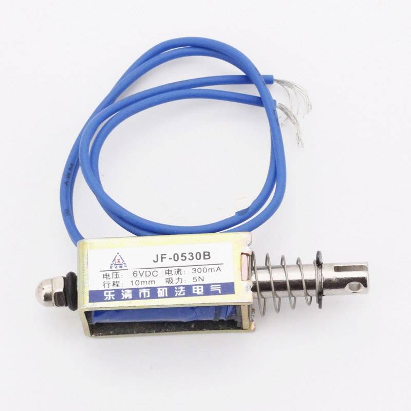

So this little Pro-Micro inspired me - I've programmed a clock, and it will drive solenoids to lift/drop the eight hammers that hit tuned tines (similar to a Fender Rhodes piano). This was after I considered a motor to drive the cylinder that plays the tunes now, but 8 solenoids gives me flexibility. And the motor would need to be a stepper, or include detectors to know where to stop it for each of the quarters, and the hour chimes are a different mechanism. The solenoids seem the way to go. I purchased them from eBay slow boat delivery, so I'll have a few weeks to work on the rest of the code and other projects.
Here's the solenoids I just purchased. The chime hammers weigh ~ 3 grams, and are lifted about 12 mm, then they just drop to hit a tine under them. Seems things are balanced and springy enough that they bend down just far enough to hit once, and bounce up, and don't have enough spring to hit a second time. They just rest above the tines. I'll probably lift at the middle, so ~ 6 grams force and 6 mm travel. I've had fun working out the details, and I think my wife will be thrilled at having the chimes again, after 20 years or so!
