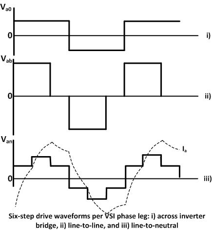

The one I am studying looks like this.
It is a basic single phase full bridge VSI. The control scheme is such that the output voltage should be a square wave of amplitude Vs and frequency 50Hz.
As per my textbook, if L=0 in the load (purely R load) switching is done such that T1 T2 conduct for 10ms, T3 T4 conduct for next 10ms.
If R=0, L is finite: T1, T2 conduct for first 5 ms, then they turn off. Load voltage in this duration is +Vs. Freewheeling diodes D3, D4 conduct for the next 5ms, load voltage during this time is -Vs. In these 10ms, inductor has charged and discharged once, with a triangular current waveform. Same cycle repeats with T3 T4 and D1 D2 in next 10ms.
So this inverter is adjusting transistor conduction time as per the load.
Is this inverter in my diagram practically designable with a transistor control logic that changes the switching time dynamically as per the load, ensuring square wave output of magnitude Vs and frequency 50 Hz ?Or is this just a simple introductory model designed to illustrate freewheeling and commutation concepts?
Not if the output is a 50 or 60 Hz sine wave. The switching frequency will be over 1000 times higher than the sinewave generated. The switch conduction times will be more like 5 usec.
The output of an H-bridge will be a high frequency rectangular wave, but the low frequency voltage and load current after the LPF will be determined by the external load impedance.
Your simplified circuit ignores the output LPF and RF suppression.
Yes. This is what I think of as an inverter. At least a good inverter.
However, there are cheap inverters, and good AC motor drives, that output square waves, or crude approximations of sine waves that don't switch at high frequencies. Like the drawing below.
If, for example, you know that your load is a motor, which is inductive and doesn't respond quickly to voltage steps, then there isn't too much to gain by providing a sine wave (the motor is the LPF). This, of course, would be a bad approach for a capacitive load.
My point is that both methods exist, and you need to understand which sort of approach you are analyzing. For the most simplified schematics, it can be hard to tell the difference. They both have transistors switching the load on and off.

The dynamics of a Square Wave (Direct) inverter and a PWM regulated Sinewave inverter are pretty different.
For a Square Wave inverter, the Output and Switching frequency are the same, Fsw=Fout. And for just the reasons you mention, estimating the losses and how they balance between the switching device and the free-wheeling diode is dependent on the current waveform.
So the focus you mention in your textbook makes sense, also note that this topology is used extensively in DC/DC converters where the load parameters are known to the designer since the high frequency transformer is part of the design.
As for line frequency inverters of this type ( ~50 or 60 hz Fout), yes some cheap inverters may use this, but in the motor drive market for a voltage source inverter they are pretty much all PWM-sine wave inverters. ( Current sourced motor drives are another animal entirely). The Square wave pulse to the motor is very hard on the motor and it's windings.
For PWM Sine Wave inverters, the low voltage (< 300 VDC or so) inverters using MOSFETs the Switching Frequency ( Fsw) can be quite high, as mentioned 1000x the output frequency ( Fout), but for higher voltage IGBT systems the ratio can be pretty low about 20x ( Fsw = Fout * 20) , to help manage the switching losses.
