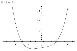

CALCULUS HELP PLEASE!?
Approximate the solution to the following equation that satisfies the given condition: x^(4) + x - 3 = 0 ; x is greater than or equal to 0Please help I'm having so much trouble!

Hello Sydney,

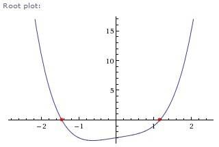

First, let's take a look at a plot of the function:
We see the positive root is near $x=1$, so that will be a good initial guess.
Newton's method gives us the recursion:
$\displaystyle x_{n+1}=x_n-\frac{f(x_n)}{f'(x_n)}$
In our case, this is:
$\displaystyle x_{n+1}=x_n-\frac{x_n^4+x_n-3}{4x_n^3+1}=\frac{3(x_n^4+1)}{4x_n^3+1}$
where $x_0=1$.
Now, I have a TI-89 Titanium graphing calculator, so what I do is enter the following:
1 [ENTER] Result: 1
(3(ans(1)^4+1))/(4ans(1)^3+1) ♦[ENTER] Result: 1.2
♦[ENTER] Result: 1.16541961577
♦[ENTER] Result: 1.16403726916
♦[ENTER] Result: 1.16403514029
Since the last two approximations are the same, we have exceeded the limit of accuracy of the calculator, and we know the required root, to 12 digits, is:
$x\approx1.16403514029$
