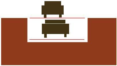

Hi,
I am planning to build a garage to park my two cars. Since I don't have much space for two vehicles, I am planning to build an underground car parking system with two levels.
For this, I need 4 synchronized cylinders for 4 corners. Load will be approx. 6000 lbs.
Can anyone of you please help me figure out how can I synchronize these 4 cylinders?
Regards,
/Lakmal
I know a lot of hydraulic car hoists have 1 main piston that pulls on 4 cables to each of the posts. This way each side is certain to lift at the same rate.
Are you planning to lower the platform as a single table? If so you can do what elevators do and have one central ram that lifts from the ground and pushes upwards.
Thanks for the idea triden. It will be lot easier than maintaining 4 cylinders. Are there any other advantages/disadvantages in this method compared to 4 cylinder option?
Here is what I mean to build. Brown area is earth.
You could consider using gear type flow dividers to divide the oil flow equally. There would be minimal oil flow across the divider which would be a problem if the loads on each cylinder was not equal. You would also need to incorporate double overcentre valves as a safety measure should a hose or ram seal fail or pilot operated check valves on the cylider ports. I would recommend using amoured hoses, something like R9R or Gates M6K spec. I have used such systems to control the folding functions on large machinery which would over balance and fall over if one side lifted before the other. Need to consider what would happen if one ram failed or was prevented from functioning due to a mechanical problem.
Keeping 4 cylinders phased is not easy, if electorics are your thing then one way may be to use cylinders with integral LVDTs or similar positional sensors linked to presure compensated flow control valves on each ram and a box of tricks to control the valves. In an application like this i would go for 1 ram and a mechanical linkage / wire ropes to eliminate the problems.
Having read the responses, I think I should go with 1 ram/ropes option. I think that is what "confused slug" also suggesting.

@Travis_King: Yes. Total load would be ~7500 lbs. If I can use counterweights (like in an elevator)? So the load on the ram would be lot lesser.
