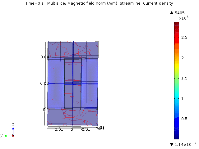

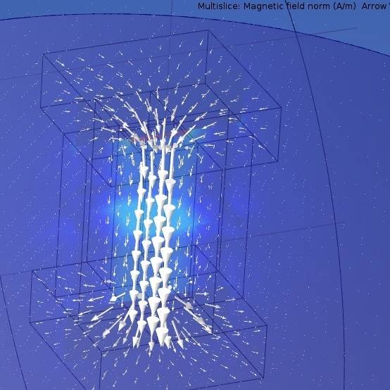

Hi guys, thank you for the input.
Sorry I didn't post more details, I have since modeled and simulated the device, and have attached some images to aid in visualization.
In the first image I show a cut away of the geometry. In the center is a region to be magnetized. The four columns surrounding it are the linear coils I described. An arrow is shown on one of the coils to indicate the direction of current flow. The 'L' shape where the coils meet are 90deg copper busbar, the faces of which are the base plates mentioned in my first post. On the bottom and top(hidden) are two blocks of soft iron to reduce the resistance of the magnetic circuit. The second diagram shows the field created by the coils.
It is important to remember that in my arrangement the wires of the coil are in parallel as opposed to a regular coil, where they are essentially in series. The 'wires' of the coil are really square copper rods.
I held the total dimensions of the coils constant and performed a parameter sweep playing with wire size and found something interesting (Note, R and L are the total resistance and inductance of the assembly, Iw is the current flowing through each wire, It is the total source current required by the source. In all cases, current was varied to produce an H-field of 50,000 A/m (± 100) within the magnetizing region) :
1/4" width wire (44 wires per coil)
R = 0.42 mΩ
L = 1.79 μH
Iw = 762 A
It = 762 x 44 = 33528 A1/2" width wire (12 wires per coil)
R = 0.1 mΩ
L = 1.62 μH
Iw = 822 A
It = 822 x 12 = 9864 A1" width wire (3 wires per coil)
R = 0.03 mΩ
L = 1.75 μH
Iw = 775 A (Expected to be > 822, we crossed an optimization turning point)
It = 775 x 3 = 2325 A
solid copper block (1 wire per coil)
R = 0.009 mΩ
L = 1.83 μH
Iw = 749 A
It = 749 x 1 = 749 A
Quite surprisingly (to me anyway, I'm a newbie), the best way to do this task seems to be by using a solid copper piece for the coil.
For my particular application, the most important thing is a short pulse time (<50 μs). It is also bidirectional so I have to use an H bridge. I have found supercapacitors that can easily deliver my current and voltage needs, what kind of circuit can I use to control the pulse time of this capacitor through an H bridge? Does the H bridge control the timing?

Hey guys, I'm very sorry but I made a terrible mistake during my simulation and had the turns per coil hardcoded to 10 instead of N (turns per layer * layers) which explains why the inductance was so similar for all of the arrangements. I halved the dimensions of the coil to reduce the requirements, here are the corrected stationary values for the wires(dimensions also halved):
1/8" width wire (48 wires per coil)
R = 4 mΩ
L = 20 μH
Iw = 82 A
It = 82 x 48 = 3936 A1/4" width wire (12 wires per coil)
R = 0.25 mΩ
L = 1.2 μH
Iw = 324 A
It = 324x 12 = 3888 A1/2" width wire (3 wires per coil)
R = 0.016 mΩ
L = 0.09 μH
Iw = 1234 A
It = 1234 x 3 = 3702 A
R = 0.002 mΩ
L = 0.01 μH
Iw = 3556 A
It = 3556 x 1 = 3556 A
We can see that there is now only a marginal improvement to total current requirement by using a single block, and the requirement is back into the kiloamp range.
After the stationary test, I changed the simulation to a transient one to model the skin effect and eddy currents. The model assumes a uniform current being applied for all times (which is a valid assumption as long as the rise time of the coil is on the order of nanoseconds). I have attached a gif showing the induced eddy currents as streamlines, as well as the time taken for the field to penetrate the material with the parameters [solid copper block, t_sim = 600 μs, I = 390 A], which only produced an average field of around 7000 A/m within the region at saturation.
It takes roughly 300 μs for the material to saturate. I am still running the simulations for the smaller wires.
That is not a valid assumption. The electric field along the surface is close to instant, but the current does not rise fast because eddy currents in the material oppose the changes.
Solid copper conductors are not optimum with current pulses. The current flow and magnetic field travel at close to the speed of light along the surface, but they only diffuses into the copper at a speed of about 2 m/sec, (yes, that is walking speed). A similar thing happens with other material in the magnetic field. You will need to use many parallel thin wires, called “Litz”, or insulated metal shims, (like the laminations of a transformer, only thinner). The electric field travels along the conductive surface in the surface insulation and so can quickly reach the volume of conductor material needed to conduct the current.
