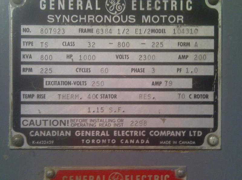

I am troubleshooting a 1967 GE synchronous motor used to run a reciprocating compressor. It is a 1000 HP machine. I am trying to figure out the size and purpose of the capacitor connected to the DC field. Is it there to absorb voltage fluctuations?
The capacitor has burnt up and can't be tested (arcing destroyed it)
Nameplate data:
KVA 800 Horsepower 1000 Volts 2300 Amp 200 RPM 225 cycles 60 Phase 3 PF 1.0
Excitation Volts 250 Amp 79

Capacitor across the field? I'd have expected either a "field discharge resistor" or a surge arrestor.

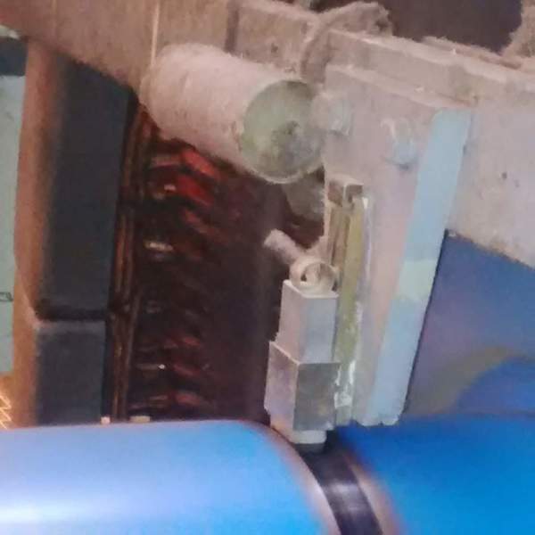

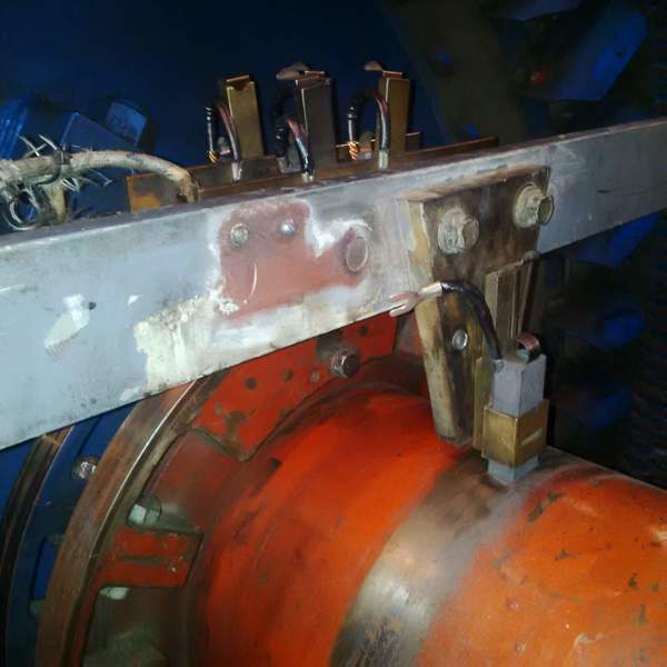

I may have been leading you in the wrong direction(as i was), it appears to be a shaft grounding system. The brush being directly on the shaft before the compressor, connected to the resistor?, then to ground through the motor casing.
I think I'm looking for resistor sizing, thanks for any help.

I'd replace it temporarily with a 240 volt light bulb , around 200 watts . If it illuminates there's trouble enough that it should be easy to find. There should be not more than a very few volts on the shaft when it's connected through such a low impedance. But the lamp won't explode if it sees full exciter voltage.(unless the field breaker trips).
Meantime maybe somebody will find the instruction book for that device. Could it be a capacitor to suppress RF from brush arcing?
Are both bearing housings insulated or just one?
The brush assembly was not being maintained properly and there was some major arcing. This is the only brush directly on the shaft. I like the light bulb idea!
' major arcing' ?
Shaft voltage arises from magnetic imbalance in the machine. Flux that's asymmetric around the shaft couples it so current tries to circulate along shaft , through bearings and back via motor frame.
A couple volts is typical open circuit . If neither bearing is insulated a very few amps might flow depending on imbalance.
Above around 500 horsepower machines are big enough it's necessary to insulate one bearing to break the circuit. Shaft current will pit journal bearings. It makes ball bearings acquire stripes so regular that your first impression is "What in the world put those raccoon tail stripes on that bearing race ? " Of course when the bearing fails catastrophically it wipes out the evidence. The natural reaction then is to mutter "Galling" and try a different grease.
When VFD's became commonplace , shaft current troubles moved into the world of small motors. So there's a LOT of information out there now much of it scholarly. Thirty five years ago it was mysterious.. i wracked my [edit:[STRIKE]brain[/STRIKE] ]alleged brain over a pair of 450KVA machines that intermittently ate bearings. They weren't insulated..
If you have significant arcing it suggests to me you might have trouble beyond a dirty brush. Maybe the insulated bearing is no longer insulated ?
Is something elevating that shaft voltage well above ground ?

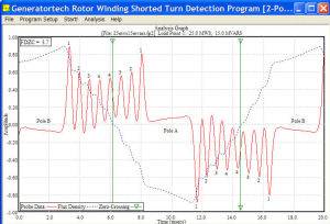

How's the vibration on that machine? Does it vary with excitation? That'd be a symptom of shorted rotor turns which cause magnetic imbalance - you have less mmf hence less flux at slots with a shorted turn. Those can be centrifugal and if bad enough can ground the field...
These guys' Dad literally 'wrote the book' on diagnosing shorted rotor turns in-situ.
Red trace is slot by slot mmf.
http://www.generatortech.com/

It is a capacitor, we were finally able to shut down a similar machine and it tested and 6.8 uf. We cleaned up the leads on the "bad" one and it tested the same.
Question is, why a capacitor to ground on a shaft grounding system?
my GUESS is it's a high frequency bypass to keep RF caused by sparking at the grounding brush from propagating on down the wires to whatever (if any) shaft voltage monitoring system is there.
You see a similar application on old brush style car generators. It keeps brush static out of the radio.
An old fashioned pocket transistor radio is useful for keeping an eye on big motors. Set it to AM and tune between stations. Walk around the motor listening to the radio. You'll get used to how radio-noisy it is . A change is an early warning that you are developing arcing or corona . Try it on rainy vs dry days... search on "Partial Discharge Monitoring"
