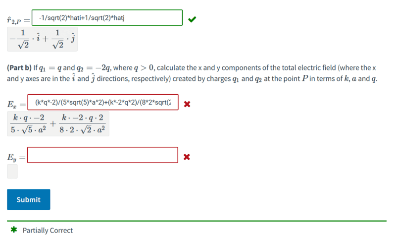

I am trying to work through the MIT free coursework to study Physics before next semester and I am having a heck of a time with the strict answer syntax, or I am having a fundamental issue with the physics, of course.

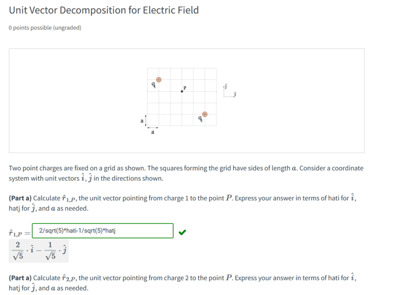

The problem is from "Week 1: Electrostatics Problem Solving Practice 1 W1PS4: Unit vector decomposition for Electric Field." in the course and I will provide the exact webpage for reference at this link.
I am trying to work on (Part b) to calculate the components of the E field. The problem asks for the answer to be in terms of "k, a, and q."
I have tried many different answers now and simplifying them is starting to give me a headache. So, I will not do so in this case - just to elaborate more in my process in solving this, as well as giving myself a bit of a rest.

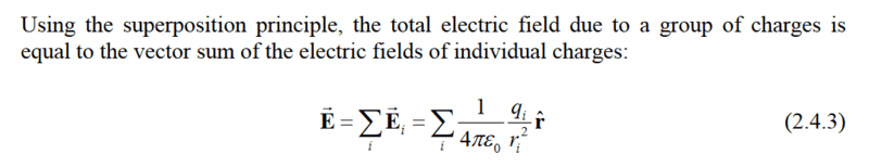

Equation (2.4.3) that you posted assumes that the charge is at the origin. If the charge is not at the origin but at point ##(x',y',z')##, and the point of interest P is at ##x,y,z##, then the electric field at point P is $$\mathbf{E}=\frac{q}{4\pi\epsilon_0}\frac{(x-x')\mathbf{\hat x}+(y-y')\mathbf{\hat y}+(z-z')\mathbf{\hat z}}{\left[(x-x')^2+(y-y')^2+(z-z')^2\right]^{3/2}}.$$If you have more than one charges, you write the electric field due to each as shown above and then add the vectors as usual.
So for the two charges you posted, you need to read the coordinates of each charge and the point of interest from the graph and plug in.

Does anything jump out as wrong with my final E field calculation? Since the first time I got this answer wrong I have had a feeling that the syntax is causing trouble, not my physics - but I have no illusions of being an expert. I just feel that I have gone through each step carefully and have already had several problems with the syntax for entering answers through this portal.
This was a long buildup into a somewhat bittersweet conclusion.
The problem was in the syntax. I think it can't properly understand the associative or distributive properties.
