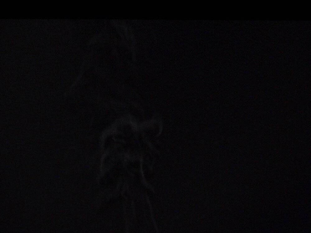

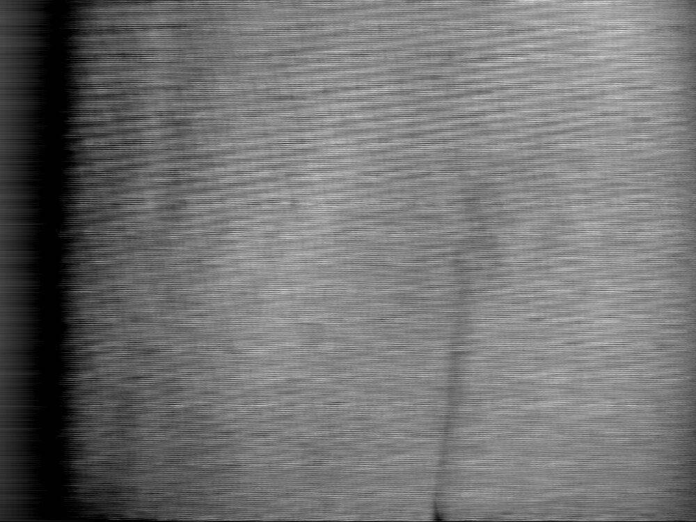

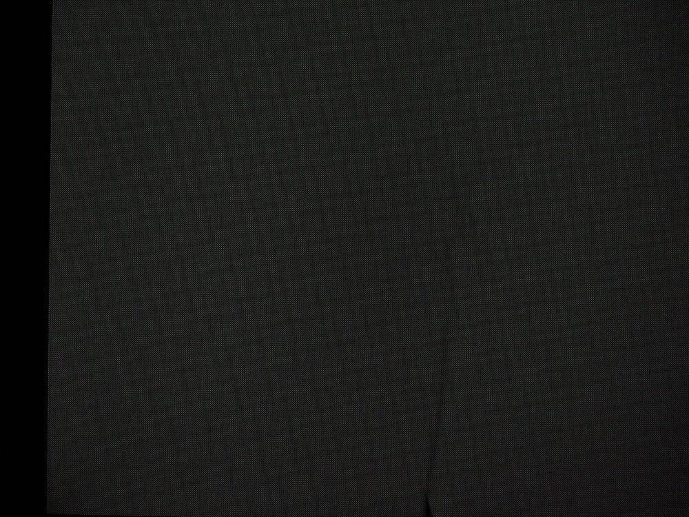

I tried the method of
https://www.researchgate.net/publication/320344649_Synthetic_Schlieren_--_application_to_the_visualization_and_characterization_of_air_convection
Instead of their "checkerboard printed on a transparent plastic sheet and back illuminated by a led panel" I made a checkerboard image and displayed it on my monitor. I took a picture (Panasonic DMC-FZ50, tripod) of the monitor from about 3m and again with a lighter flame halfway between. After subtracting the images as described in their supplementary materials (at the end of the paper), I get:
I accidentally subtracted two flame images:
I tried to upload my checkerboard images (1920x1200 and 1440x900) but PF munged them into 800 wide. Is there a way to do this? The PNG files are < 50k.
That's a really cool method for displaying the way convection currents deflect the light. Clever idea that seems to be based on sampling, rather than straight phase differences. (?)
Imagine that the pitch of the chequerboard needs to be optimal because you would want the deflection always to be less than the pitch or you could get aliasing. Your results are pretty impressive - no doubt that the waves are there. Excellent idea to use a TV screen as your source as you can easily change the pitch of the board and the display costs nothing.

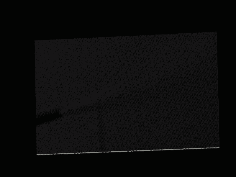

This is air blowing out of a vacuum cleaner ("crevice tool" connected to the exhaust end):
At the bottom is a knife blade poking into the air stream. Camera-screen distance ~ 5m. The camera must be focused on the screen, so the vac and knife are out of focus.
This was done with a lesser camera (Samsung D60), distance 2m:
I can see some features in those very dark images and they look encouraging. If you tinker with the contrast and brightness of those pictures, you (and we) may see more detail. You are sure to have access to a photo processing package - it doesn't have to be £10 per month for Photoshop!
There are a number of issues here:
1) It's supposed to be dark. If I put two identical images into the "subtract" process it comes out black. I'm not even sure what the "subtract" is mathematically (I found FIJI's explanation, but it was late :oldconfused: ).
2) Detail is limited by the focus issue. With the better camera I can reduce the aperture to get more depth of field, but the trade-off is longer exposure, which means motion blur. With a printed checkerboard as in the paper I could use photoflash to "freeze" the motion, but that won't work for the monitor image.
3) I was using "AUTO" setting, so the flame probably influenced the exposure. I could use some non-luminous heat source or use manual settings (on the better camera).

The cited paper (in the Supplementary Materials) suggests a contrast adjustment and Gaussian blur but I didn't think it was an improvement.
sophiecentaur said:
I am surprised that the images are not 'cranked up to grey' in the same way that night time scenes with low lighting are
The actual photos are bright - it is the subtracted image that is dark.

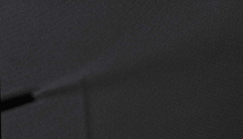

This is with contrast adjustment and Gaussian blur.
Ahh. That's much easier to see. It's getting to be impressive. Your project encompasses several different disciplines; you have AstroPhotography and Sampling methods to deal with. All good stuff though and worth getting into.
I can see hints of the grid in the image which could be eliminated / reduced by increasing the radius of the Gaussian blur control. Can you post an image of the grid and also the effect of the blur in it? That filtering can be experimented with before you do the Schlieren stuff. It's a compromise between getting rid of the grid pattern without degrading the wanted pattern and you have to suck it and see.
You haven't commented about what you focus on; is it the grid itself, rather than the knife edge? The processing really needs the sharpest grid to work on, I think. The knife edge may turn out a bit fuzzy but the contrast of the Schlieren pattern could be improved that way. Astro Photographers do a lot of 'massaging' of their best images and it's common to do a montage, to enhance / suppress some features. If you have an image processing app that allows you to mask, you could get the best of both worlds by laying the schlieren image on top of a sharp knife edge. All's fair in love and photography!
PS For the subtraction to work well, you need the two images to be perfectly registered. That means firm tripod mounting unless your image processor allows you to nudge one image to register with the other. Also, afaics, the contrast of the original i pictures should be high (and equal for the two); the processor has plenty of information about the relative phases of the two grids. You are taking the difference between two large quantities and they need to be different only in respect of the relative phases of the grids; it's a bit of a balancing act unless you can find some software to do it for you. There are a number of Astro 'Stacking' applications that would do it and drag the maximum useful info out of your measurements.

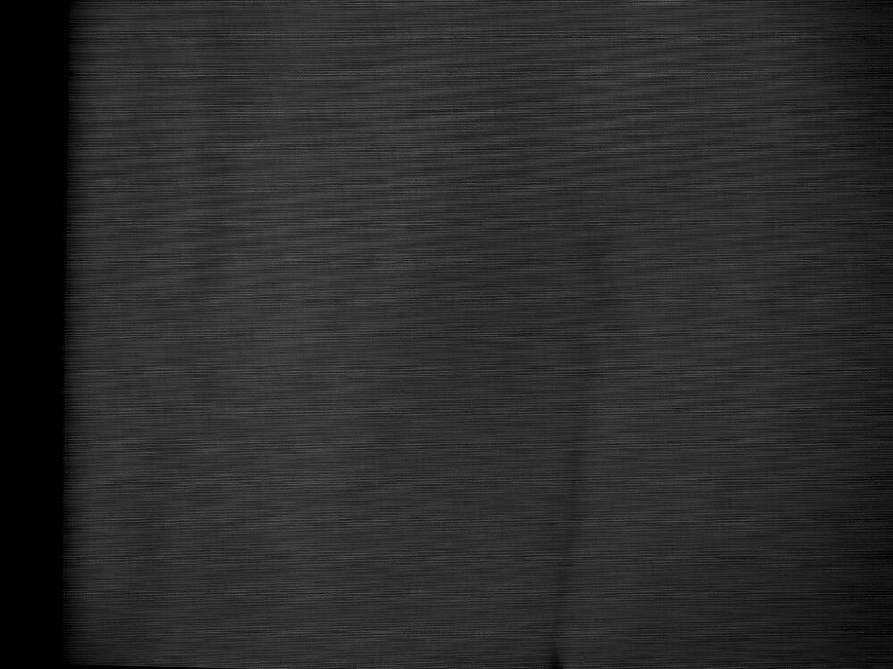

Here is a zoom of part of a subtracted image that should be black. The pattern is due to the camera moving slightly between shots.
The white horizontals and coloured verticals are because the RGB lines within each pixel are vertical.

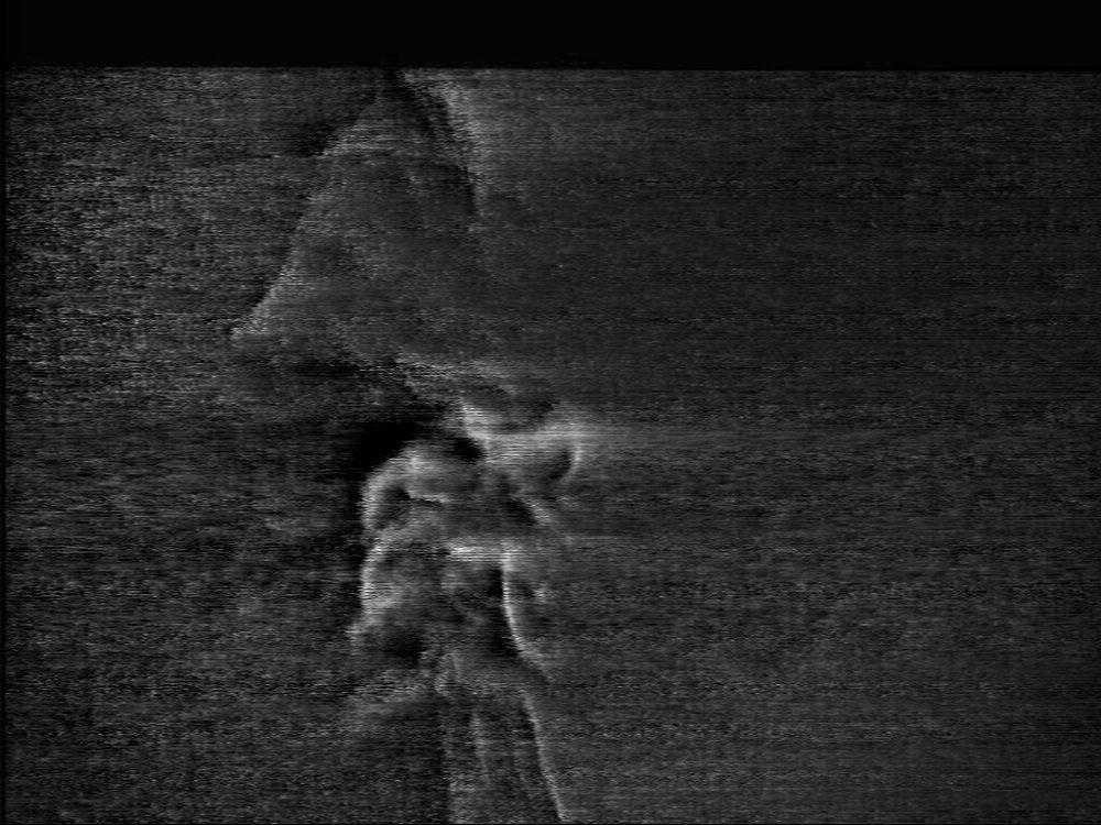

As a hobby project I developed a maximum entropy image reconstruction algorithm for noise reduction in image processing. I tried it out on the knife in vacuum cleaner exhaust image.
My program generated this image:
You can see some of the features of turbulence caused by the knife which are not visible in the original.

This is very encouraging. Have you considered do a bit of tiffling with 'curves and levels' on Photoshop (or equivalent) to make the image more visible to the eye? It's not cheating and would make the results much more accessible. Increase the gain / slope a bit but keep the blacks black.
Your program could easily identify the brightness range and do some useful scaling on its own, without human intervention.

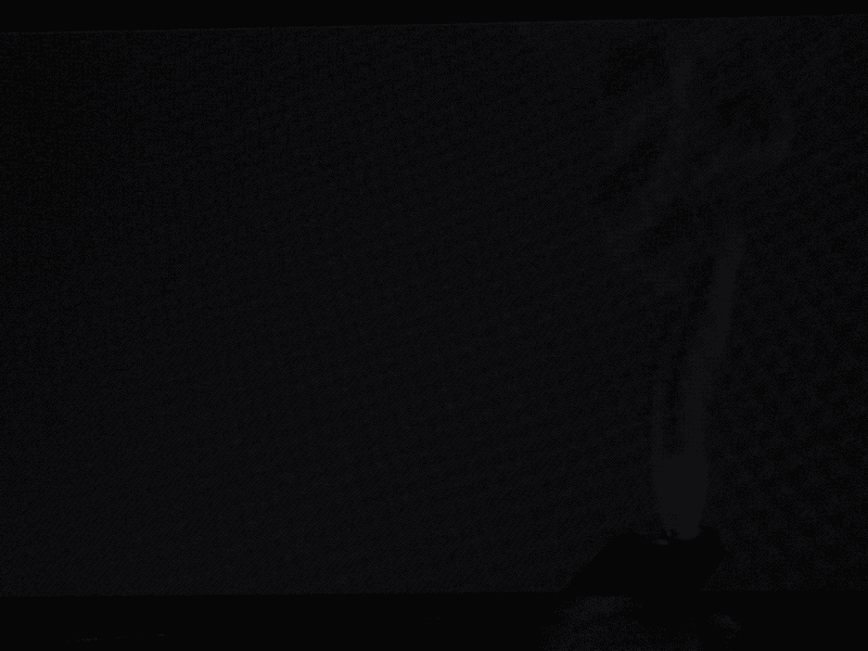

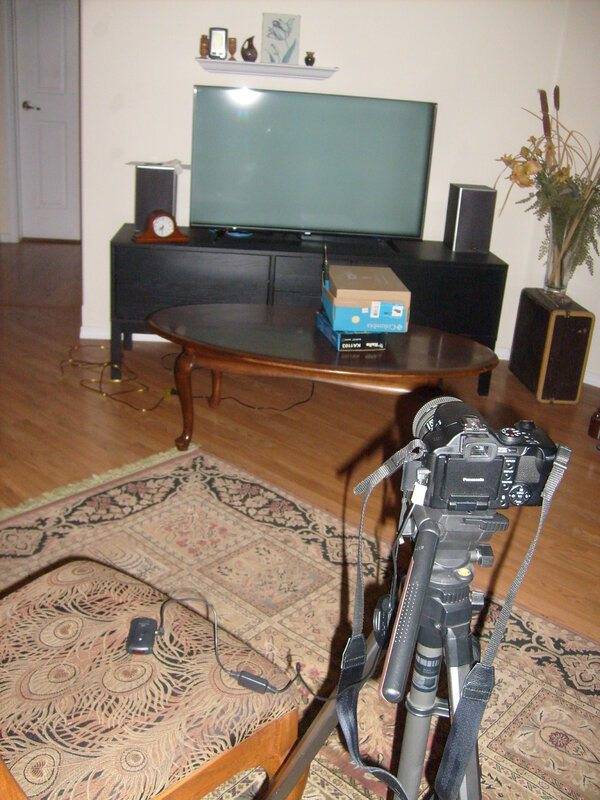

This is the setup with the 4K TV. The checkerboard image is on a USB stick plugged into the TV.

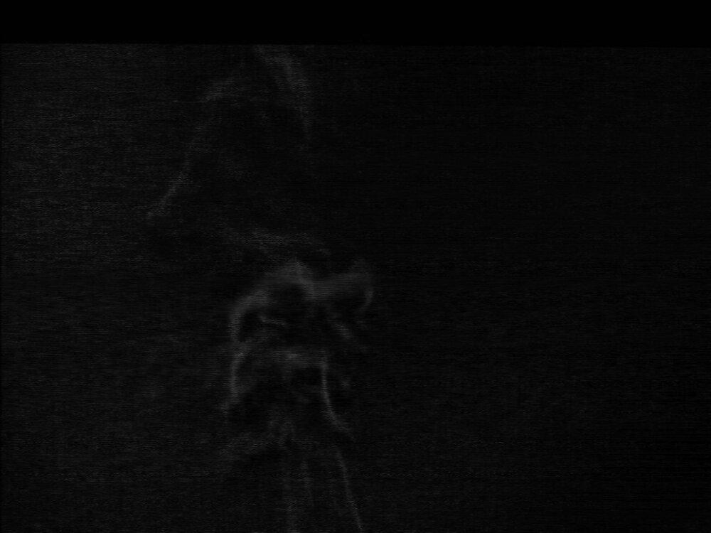

This is the hot air rising from a soldering iron:
and from a candle (I didn't wait for the air to settle):
Good work. It's such a good idea; you're obviously getting somewhere with it.
You can probably improve on the contrast with 'Curves and Levels' controls in a photo imaging app. Astrophotographers are doing that all the time. What is the shape of the brightness profile (ie how sharp and what contrast and spatial frequency) of the grid you start with? There's probably an optimum which could perhaps give you much more visible.
How does distance from the camera affect things? (i.e. sensor pixel / display pixel spacing ratio)
Total darkness could also help to squeeze as much out of the levels and curves treatment.
Also, what do you get when you use a piece of glass or a lens ( in place of the hot gases? If you can get a one square displacement by refraction, you should be able to get near full contrast in your final image. One step at a time could be a good approach, to find what's your limiting experimental factor.

Thank you for your interest and observations of my maximum entropy noise reduction (MENR) hobby project. I don't have Photoshop. I use OpenCV and program subroutines in C++. I have to figure out how to implement histogram equalization of the histogram of the entire image coupled with a local stretching function. I have, however, developed an alternate technique which I call "semi-holographic contrast enhancement"(SHCE).
For your amusement, I processed the two images recently posted by @Keith_McClary using both MENR and SHCE. For Keith's image
MENR yields
I processed this image with SHCE to get
For Keith's image:
MENR yields
Processing this image with SHCE yields
