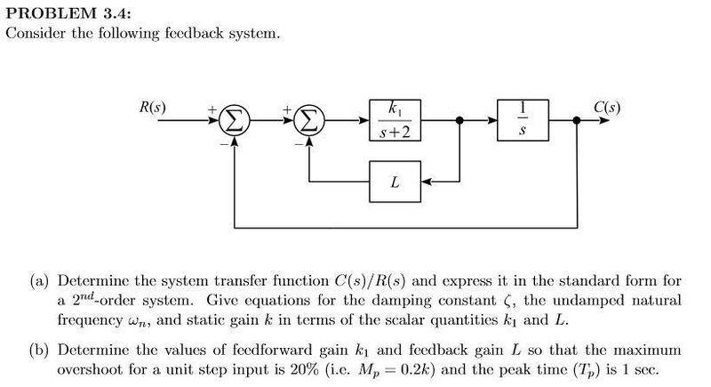

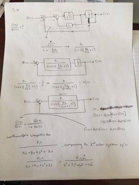

Problem and work attached.
It is mostly diagrams so I have just uploaded the pictures.

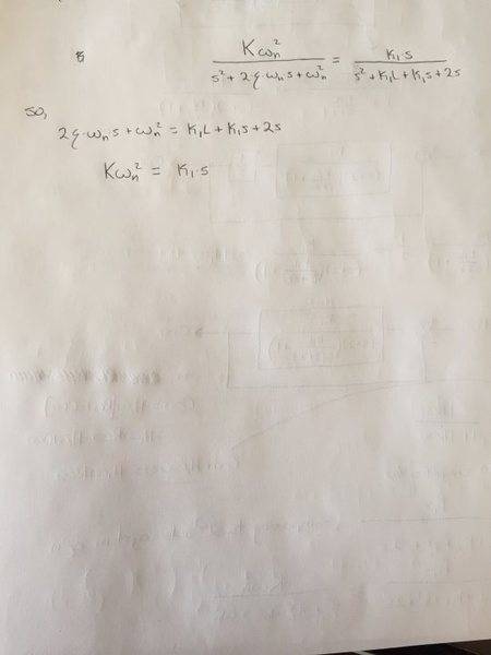

I think what I did to determine the transfer function was correct. I'm not quite sure how to do the last section of part (a) where I need to determine the dampening, static gain, and natural frequency as functions of k1 and L.
I tried to set the general equation for a second order system equal to my transfer function and then I set the numerator and denominators equal to each other but I'm not sure where to go now.
Could someone verify that what I did for the transfer function is correct, and help me determine the functions to describe the dampening, natural frequency, and static gain?

I think, trhe last block diagram looks OK - but recalculate the corresponding transfer function.
I am not sure if it is correct.
Recalculating,
[itex] H(s) = \frac{k}{s^2 + kLs + k + 2s}[/itex]
Does this look right?
So now I would have,
[itex] 2ζωs + ω^2 = kLs + 2s + k[/itex]
[itex] k = Kω^2 [/itex]
I think, the transfer functionis correct now.
You should put together both expressions with "s" and compare each factor in the denominator with the denominator of the general (normal) form.
This would result in w²=k which looks a bit uncommon to me because of the units.
I am an engineer and for this reason I propose to write from the beginning H1=k/(2+sT1) and H2=1/sT2 (later we set T1=T2=1sec).
Now, all the expressions will have the correct unit.
As a result, the transfer function is
H(s)=N(s)/D(s) with
N(s)=k/T1T2 and D(s)=s²+s(2+kL)/T1+k/T1T2
From this, it is easy to derive that
wn²=k/T1T2 and "theta"=(kL+2)/2wnT1=[(2+kL)*SQRT(T2/T1)]/2k
Now we can set T1=T2=1sec.

why are you over-complicating the problem. You can't arbitrarily change the transfer functions. as a result those values you added will ALWAYS be 1.
it might be good to point out that the time constant of a pole is 1+sT, or write it in the form of (k/2)/(1+s/2), but even that is trivial.

2ζωs+ω2=kLs+2s+k
yes. now evaluate that equation for zeta and natural frequency
