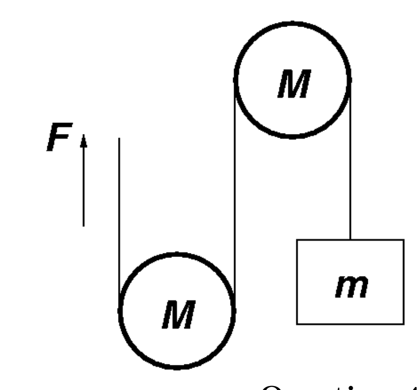

A system of two fixed pulleys, each of mass M and radius R, is set up as in the
diagram below. The masses and pulleys are connected by light inextensible strings,
which do not slip on the pulleys. A force of magnitude F is applied as shown to
one of the strings, in order to lift the block of mass m. Calculate the maximum
possible acceleration of the block, given that any string will break if the tension in
it exceeds 5Mg. You may assume that the relevant moment of inertia of each pulley
is MR2/2.
F=ma
t=Iα
I tried to solve The system of torque as following.
I labelled pulley one is the one in the left, and two as the one on the right.
α=a/R
t1=(-F+T1) R=MR^/2α. So -F+T=Ma/2
for pulley 2 (T1-T2)R=MR^2/2. So T1-T2=Ma/2
for The box T2-mg=ma
add the last two equation, to get that T1-mg=Ma/2+ma.
Multiply by negative for the first equation and add it to get that.
a=(F-mg)/m.
I feel it's wrong since it doesn't involve the mass of the pulley. Or is it the right and I just over complicate the things

It looks like you have adopted the convention that clockwise torques are negative and counterclockwise torques are positive. That's fine, but it should also apply to angular accelerations. Note that the pulleys have opposite angular accelerations but in your equations they are both positive. (The angular acceleration of pulley 2 is missing but it is assumed positive.) Which one of the two should be positive? Also, please use parentheses if you are not using LaTeX. MR^2/2α is interpreted as ##\frac{MR^2}{2\alpha}##.
Thanks but how can I know that they have opposite angular acceleration is it always the case in any two pulley problem
I think the second pulley should be the one with positive, angular acceleration. since it's moving counter clock- wise and the first one is negative it's moving clockwise
Yes. I think you can finish the problem now.

I am confused to which one of them put the maximum value of the tension.
Did you solve the 3 equations to get the tensions and the acceleration?
I tried to start from the beginning I putted the positive direction as the direction in which the pulley will move.
So for the first pulley the one in the left. the rope will move clock wise so I putted the clock wise as positive.
(F-T1)R=(1/2) MR^2(a/R)
So F-ta= (1/2) Ma
For the second pulley the rope will move clockwise
So (T1-T2)R=1/2 MR^2 (a/r)
so T1-T2=1/2 Ma
Last equation for the box
T2-mg=ma
Now we know that maximum tension is 5Mg since T1 and T2 is positive and
T1=1/2Ma+T2
Then T1 is greater than T2 .
Based on that T1=5Mg maximum value
After that I went to put it into the last equation
T2-mg=ma
where T2=5Mg-1/2 Ma
So lastly I found the value of a.
a=(5Mg - mg)/(m+1/5 M)
I hope that I did it It's easier than I expected
You still didn't get it. First of the string (at least the parts that are not wrapped around a pulley) move in straight lines. All points have the same magnitude of linear acceleration and that allows you to say ##a=\alpha R## to relate the angular acceleration to the linear acceleration. Second, one pulley spins faster and faster clockwise and the other faster and faster counterclockwise. This means that if you choose ##\alpha_1## positive, ##\alpha_2## must be negative. The torque equations are ##\tau_1=I_1\alpha_1## and ##\tau_2=I_2\alpha_2##. If you set ##\alpha_1=a/R##, what should ##\alpha_2## be in terms of the magnitude of the linear acceleration ##a##? Third, since you adopted the convention that clockwise is positive, any product ##T_iR## that would produce a clockwise angular acceleration of a particular pulley should appear with a ##+## sign on the left side of the equation. Likewise, any product ##T_iR## that would produce a counterclockwise angular acceleration of a particular pulley should appear with a ##-## sign on the left side of the equation. You need to be consistent as @haruspex advised in post #6.

@kuruman when I followed the convention of clockwise and anti clock wise I got the same equation as the one in my last post
(F-T1)R=1/2 MR^2 (a/R)
So F-T1=1/2 Ma
and (T2-T1)R=-1/2 MR^2 (a/2)
So T1-T2=1/2 M(a)

It's not a stupid question. The correct approach will allow you to answer it on your own. Play a movie in your head and imagine a hand pulling the free end of the string with constant force ##F##. What happens to the three straight pieces of the string? The left part goes up and the middle part goes down. If that is the case, how is the left pulley going to turn, clockwise or counterclockwise? Now look at the pulley on the right. The middle part of the string goes down and the right part goes up. If that is the case, how is the right pulley going to turn, clockwise or counterclockwise? It's as simple as that. When you do physics problems, it often helps to play a movie in your head and imagine how a system might evolve in time.

The two equations are correct. There is a third equation that involves the hanging mass. That will give you three equations and three unknowns.

I agree with your 3 equations and that T1 is the one that reaches the value 5Mg first. I disagree with your final expression for the acceleration when T1=5Mg. Reheck your algebra or post it here if you want it to be looked at.
On edit: The factor ##(5Mg-mg)## up front is correct. It says that if you hang a weight equal to the breaking limit of the string, it will break in the static case of zero acceleration. It's what multiplies that factor that I disagree with.

Thanks mate, I solved for a again I think I made an algebra mistake the answer should be (mg-5Mg)/(m-1/2M)

It's still not right. If you posted your workings, I would be able to point out where you went wrong. You have negative sign problems that you will need to trace.

Thanks for being patient with me.
First step T1=5Mg So
T2=T1-1/2Ma=M(5g-1/2a)
From last equation
M(5g-1/2 a ) - mg = ma So
5Mg-mg=a(m+1/2 M)
a= (5Mg-mg)/(m + 1/2 M).
I need to be super careful in the exam about the sings.
Mate can you have a look of a similar problem that caused me confusion about angular and tangential acceleration.
This matches my answer.
