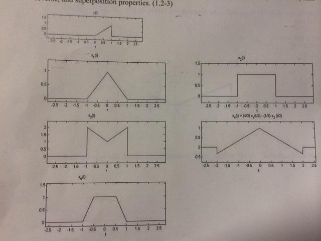

In summary: First I thought I would just take the top plot and subtract the bottom plot. But then I realized that I would have to reverse the time scale for that to work. So I did that and it came out looking like this: x(t) - x(-t) = x(t+1) + x(-t+1) Which gives me this equation: x(t) = (x(t+1)+x(-t+1))/2 Which when solved gives me this: x(t) = (-t+1) + t
Alpha_Centauri
Systems and Signals questions---plots
Problem: Express the bottom 5 plots in term of x(t) (the top plot) with its time shift, time scale, time reverse and superposition properties. (see attached picture)
I have very little notes on this and feel like I have done this a few years ago, but my memory is failing me. I am not understanding how to get the plots just from x(t).
My attempt for x1(t): it looks like it is just x(t) but 2 of them back to back with one being reversed.Also it is shifted left by 1. So I figured it would look something like x(t+1) + x(-t+1).
I have no idea if that is right or not or how to check it. If anyone could help teach me with examples or have a good link that can teach me that would help a lot.
Thanks!

Thanks NascentOxygen! I will keep that in mind for future post, but for this I think I was able to figure it out!
