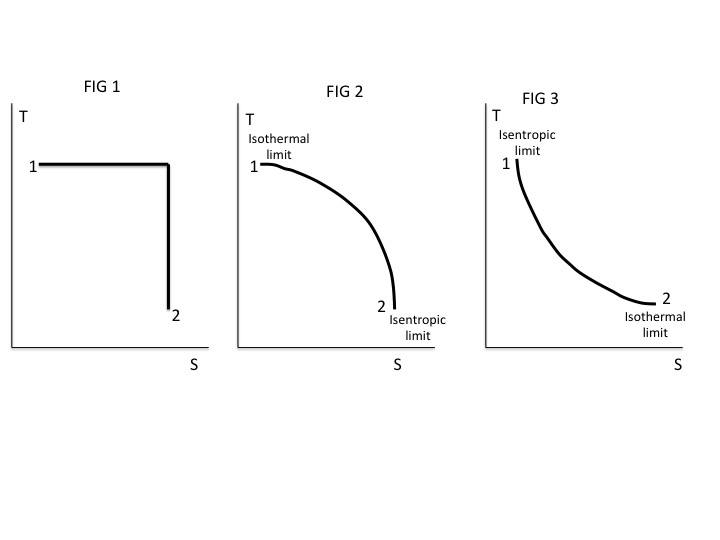

Just so I understand correctly. See the figures below.
Fig 1 shows what I originally thought you meant when you said "Another example is an isothermal expansion followed by an adiabatic expansion". You subsequently correctly surmised I was thinking you were talking about the expansion portion of a Carnot cycle. T(S) here is not continuously differentiable, which is why I balked.
Correct me if I'm wrong, but Fig 2 shows what I think you mean by "You can take the heat added all the way down to the isentropic limit before the change in entropy becomes zero." My original concern was for the counter intuitive idea that a decrease in temperature could produce an increase in entropy. Your example shows that, for the system, it can (though entropy is decelerating in the transition between the isothermal and isentropic limits). However, would I be correct in saying that the overall change in entropy of the system plus the change in entropy of the "continuous sequence of reservoirs" which are removing the heat from the system, is zero for the reversible process?
Fig 3 is essentially what was given in the link we are discussing. Is there a physical interpretation we can give for this curve?
I was thinking more like this: For an isothermal reversible expansion, ##PV^n=C## with n=1, heat is added, entropy increases, and temperature is constant. For an adiabatic reversible expansion, ##PV^n=C## with ##n = \kappa## (say, 1.4), no heat is added, entropy is constant, and temperature decreases. Now, for, say, a polytropic expansion with ##PV^n=C## with ##1<n<\kappa##, heat is added (but not as much as in the isothermal case), entropy increases (but not as much as in the isothermal case), and temperature decreases (but less than in the isentropic case). So the isothermal case and the isentropic case are the limiting cases I would consider for polytropic processes featuring an increase in entropy and a decrease in temperature. A polytropic process of this type would be an example of one with a graph like in the link. Of course, it all depends on how one controls Q as a function of V, and there are many other examples that are possible.
Chestermiller said:
Yes. You can take the heat added all the way down to the isentropic limit before the change in entropy becomes zero.
Correct me if I'm wrong, but Fig 2 shows what I think you mean by "You can take the heat added all the way down to the isentropic limit before the change in entropy becomes zero." My original concern was for the counter intuitive idea that a decrease in temperature could produce an increase in entropy. Your example shows that, for the system, it can (though entropy is decelerating in the transition between the isothermal and isentropic limits). However, would I be correct in saying that the overall change in entropy of the system plus the change in entropy of the "continuous sequence of reservoirs" which are removing the heat from the system, is positive?
Fig 3 is essentially what was given in the link we are discussing. Can we interpret this as the gradual removal of heat starting with an isentropic process and ending with an isothermal process?
Excellent! So we are talking about a polytropic process with n being a variable (i.e. constantly changing) in the range between 1 (isothermal limit) and k (isentropic limit, e.g., 1.4 for ideal gas)? But doesn't that apply to Fig 2 since Fig 3 (the link) starts at the isentropic limit?

OK. but which figure (1 or 2) applies? Your example started with an i

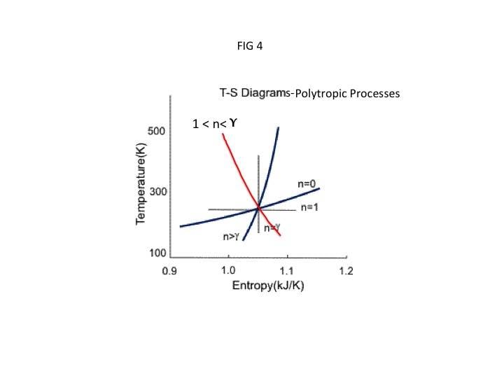

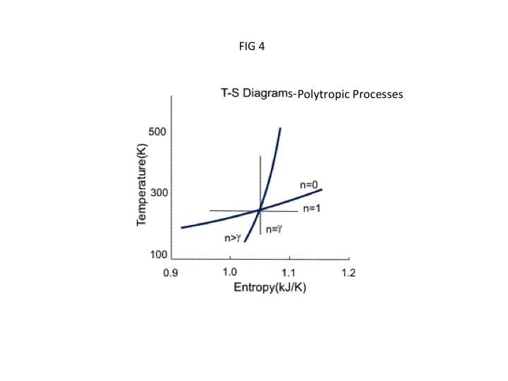

Before I even try to follow this, I need to go back to your previous answer, that n is a constant for the entire process. I'm afraid I'm losing you (please be patient) and starting to feel stupid. Fig 4 below shows, as I understand it, TS diagrams of different polytropic expansion processes with different, but constant values of n. None of them associates a decrease in temperature with an increase in entropy.
The graph doesn't show any cases between n = 1 and n = gamma.
Oops! Sorry. Didn't look at it closely enough. Probably something like added red curve below.
Likes Chestermiller
We have $$\ln{P}+n\ln{V}=\ln{C}$$
and, from the ideal gas law, $$\ln{P}+\ln{V}=\ln{(mR)}+\ln{T}$$where m is the number of moles of ideal gas. So,$$d\ln{P}+nd\ln{V}=0\tag{1}$$and$$d\ln{P}+d\ln{V}=d\ln{T}\tag{2}$$Subtracting Eqn.1 from Eqn. 2 then yields $$d\ln{T}=-(n-1)d\ln{V}\tag{3}$$Also, for an ideal gas, we have for the entropy variation:
$$dS=m(C_vd\ln{T}+Rd\ln{V})$$Substituting Eqn. 3 into this relationship then yields: $$d\left(\frac{S}{mR}\right)=\left[\frac{1}{(\gamma-1)}-\frac{1}{(n-1)}\right]d\ln{T}$$For ##\gamma=1.4## and ##n=1.2##, this gives: $$\frac{d\ln{T}}{d\left(\frac{S}{mR}\right)}=-0.4$$
Oops! Sorry. Didn't look at it closely enough. Probably something like added red curve below. View attachment 267624
Nice. The polytropic equation is just one example of an expansion path where dT/dS is negative.
