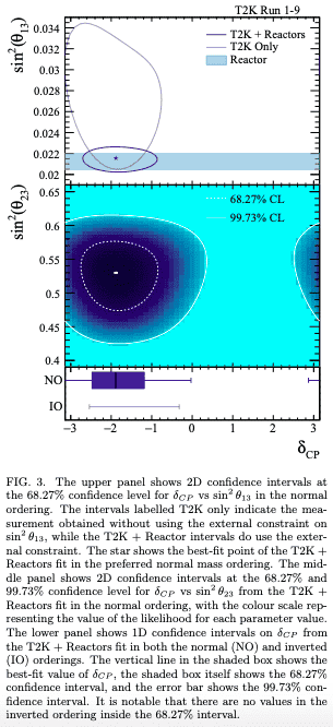

It is worth pointing out that the measurement is not very precise. It is just barely ruling out the CP-conserving values of ##\delta## at ##3\sigma##, the ##3\sigma## confidence interval being ##[-3.41,-0.03]## (CP-conservation would be 0 or ##-\pi## (equivalent to ##\pi##). That is almost half the range still allowed, so if one wants to be mean one could say that the title should be "Almost no constraint on ...". A better title would have been "Strongly disfavouring matter-antimatter symmetry in the lepton sector" in my opinion.

Orodruin said:
It is just barely ruling out the CP-conserving values of δδ\delta at 3σ3σ3\sigma, the 3σ3σ3\sigma confidence interval being [−3.41,−0.03][−3.41,−0.03][-3.41,-0.03] (CP-conservation would be 0 or −π−π-\pi (equivalent to ππ\pi)
Moreover, ##-\pi## is in that range. The paper only claims to have ruled out the CP-conserving values at 95% confidence level.
Likes atyy, ohwilleke and nrqed
You are right, my mind for some reason swapped the order of the decimals in the 3.41 ... :oldeyes:
I think that is too weak. It rules out half of the range with >3 sigma and disfavors a good part of the other half as well. This is not a search for a new particle/process where you can safely dismiss 3 sigma hints because of the look-elsewhere effect. It's a measurement of a free parameter.

The best fit value is -0.60π + 0.22π -0.18π (in radians). This is consistent at a one standard deviation level with maximal CP violation which is -0.50π. It is inconsistent with zero CP violation at almost, but not quite, three sigma significance.

Roughly half the possible parameter space is ruled out at the three sigma level. The best fit value at plus or minus one sigma, is about 20% of the possible parameter space. The existence of CP violation in neutrino oscillations is established at just slightly less than three sigma, but close to 98-99% likelihood.

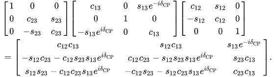

When you are at a given starting point in a physical event involving a neutrino, you need to use the PMNS matrix to determine what the probability is of the neutrino undergoing an oscillation of a particular type. This is determined by entries in the PMNS matrix, each of which is an algebraic combination of one or more of the four PMNS parameters (the exact combination depends upon which of the mutually equivalent schemes are used to do the parameterization, even the CP violation component can be parameterized in different ways). The most common parameterization is as follows (per the link to the PMNS matrix above in this comment):
in which s refers to Sine, c refers to Cosine, the subscripts identify which of the three other PMNS parameter angles is being used, e is Euler's constant, i is the imaginary number, and the CP violating parameter appears in the exponent of the Euler's constant terms (note that e^iπ=-1).
In the absence of CP violation, the probability of going from State A to State B is also identical to the probability of going from State B to State A (and the Euler's constant term in each of the PMNS matrix is equal to 1 because anything other than zero, to an exponent of zero is equal to 1). In the presence of a non-zero CP violation parameter, the probability of going from State A to State B is different in a quantifiable manner, from the probability of going from State B to State A.
Another way to state the same thing is that the CP violation parameter quantifies the amount by which the oscillations of neutrinos differ from the oscillations of antineutrinos.
In four of the nine PMNS matrix entries (it is a 3 x 3 entry matrix), the CP violation parameter's contribution is negligible. But, in the other five those nine matrix entries, the CP violation parameter is more significant.
The parameters themselves are not observables. The experiments attempt to discern the CP dependence of particular entries of the PMNS matrix where CP violation is more significant (by counting the number of events of each type compared to what would be expected with no CP violation given our best estimate of the other neutrino oscillation parameters and the relative neutrino mass eigenstates) and use that data to try to infer the value of that parameter.

NOvA measured the same parameter, and their result is nearly a perfect opposite of what T2K sees (but with larger uncertainties). Presented at Neutrino 2020 (virtual conference)
Slides
Here are both in one image (from slide 29)
Interestingly: T2K has the same preferred regions for the inverted mass ordering (one light neutrino, two "heavy" neutrinos), but for NOvA this is inverted. With the inverted hierarchy both experiments favor the same region. The inverted hierarchy is disfavored from other measurements, however.
Likes vanhees71 and ohwilleke
Eyeballing the image, there is a point at roughly 1.15pi and sin^2theta(23)=0.55 (about 48º) that is within the one sigma range of both experiments.
The collective evidence disfavoring an inverted hierarchy is too strong to be displaced much by these two results with big error bars.
