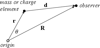

I have solved the problem correctly (confirmed since the answer is given in the book.) I could not figure out how to solve the problem. Just to see what happened, I took the legendre polynomial factor outside the integral, and I stumbled onto the correct answer. Was my attempt incorrect, and my correct solution a lucky coincidence, or was my method correct? If my method was correct, why are you allowed to take the legendre polynomial outside the integral? It seems to me that theta must certainly depend on z (I was convinced of this based on fig. 3.28 in Griffiths). It can also be seen from:
where r corresponds to z in my problem. Certainly in the figure above if you changed r theta would also change.

You got lucky. That equation from ScienceWorld isn't even right. There should be a [itex]P_n(\cos\,\theta)[/itex] outside the integral and a [itex]P_n(\cos\,\theta\,')[/itex] inside the integral, where [itex]\theta\,'[/itex] is one of the terms integrated over by [itex]d^3\mathbf r[/itex].

No, there's nothing wrong with his equation; it results from a straight forward expansion of [itex]|\textbf{R}-\textbf{r}|^{-1}=(R^2+r^2-2rR\cos\theta)^{-1/2}[/itex] in the case [itex]R>r[/itex]
Careful, since [itex]\theta[/itex] is the angle between [itex]\textbf{r}[/itex] and [itex]\textbf{R}[/itex], it will certainly change as [itex]\textbf{r}[/itex] changes in direction, but changing the length of [itex]\textbf{r}[/itex] will have no effect on the angle between it and [itex]\textbf{R}[/itex].
When you integrate over [itex]x[/itex] and [itex]y[/itex], the direction of [itex]\textbf{r}[/itex] will change, but the charge density is zero except for [itex]x=y=0[/itex], and hence contributes nothing to the integral. The only non-zero contribution comes when [itex]\textbf{r}=z\mathbf{\hat{z}}[/itex], and this vector points in the same direction throughout the integration over [itex]z[/itex], so [itex]\theta[/itex] will be be a constant in your integral.

I maintain my position that there is still nothing wrong with his equation
[tex]V(R)=\sum_{n=0}^{\infty} \frac{1}{R^{n+1}}\int r^n P_n(\cos\theta)\rho(\textbf{r})d^3\textbf{r}[/tex]
even in the general case, so long as [itex]R>r[/itex].
In the above equation, [itex]\theta[/itex] is defined as the angle between the vectors [itex]\textbf{R}[/itex] (the position of the field point relative to the origin) and [itex]\textbf{r}[/itex] ((the position of each source point [itex]dq=\rho(\textbf{r})d^3\textbf{r}[/itex] relative to the origin), not as the polar angle of [itex]\textbf{R}[/itex] or [itex]\textbf{r}[/itex] in general. This definition should be clear from the OP's diagram.
