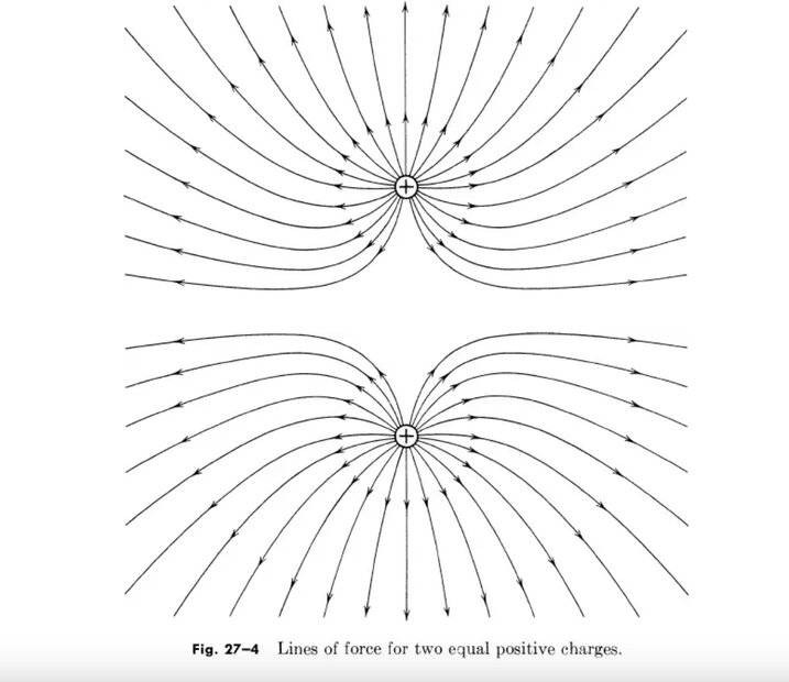

In Halliday & Resnick, \mathcal {Physics for Students of Science and Engineering}, In Fig 27-4, consider any two lines of force leaving the upper charge. If the angle between their tangents for points near the charge is \theta, it becomes \theta/2 at great distances. Verify this statement and explain it."

https://www.academia.edu/49244478/Physics_Part_II
The figure is on p 668, the text on p 681.
E.g. consider a line that starts out almost straight down from the upper charge. It does appear that this will asymptotically head off horizontally. But I don’t see how to apply the hint in general.

Here is the figure. This has to do with Gauss's law. Enclose one charge with a gaussian sphere that has a radius much smaller than the charge separation. Repeat with a gaussian sphere of radius much larger than the charge separation. In the first case one essentially encloses a monopole ##+Q## and in the other a monopole ##+2Q##.

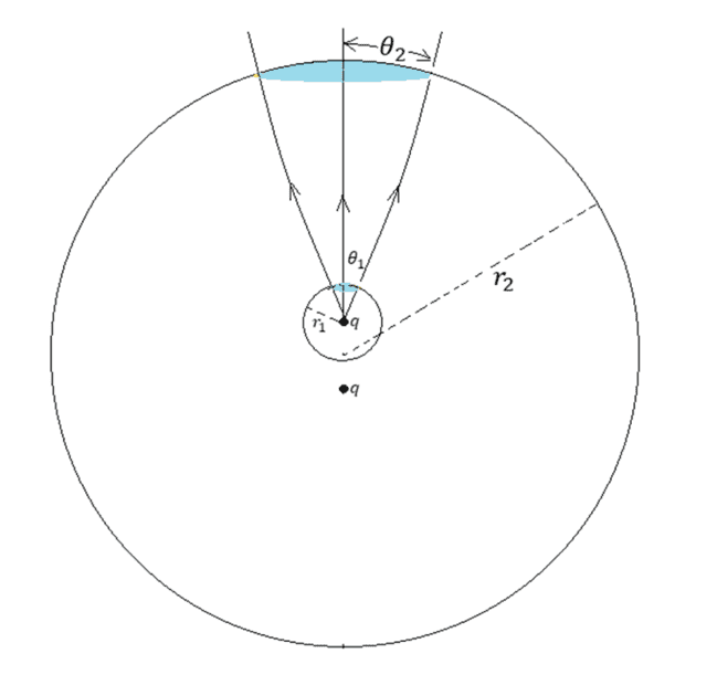

The field lines emerging through the inner sphere between ##\theta## and ##\theta+d\theta## from the line joining the charges do so through a solid angle ##2\pi\sin(\theta)d\theta##.
If those same lines reach the outer sphere between ##\phi## and ##\phi+d\phi## then, since the overall density has doubled, ##\sin(\theta)d\theta=2\sin(\phi)d\phi##, leading to ##\cos(\theta)=1+2\cos(\phi)##.

The two charges are labeled ##q##. ##r_1## is the radius of an imaginary sphere centered on the top charge. We take ##r_1## small enough that the points on the sphere are "very near" the top charge. ##r_2## is the radius of a large sphere centered on the point between the two charges. ##r_2## is "very far" from the two charges.
We have a central electric field line running from the top charge vertically upward. It remains straight all the way to infinity. Imagine a "cone" of electric field lines all making an angle ##\theta_1## to the vertical field line. I've only drawn two of these lines, one tilted to the right and the other to the left. These field lines will be curved so that when they reach the spherical surface at ##r_2##, they make an angle ##\theta_2## to the central field line. The book claims that ##\theta_2## will equal half ##\theta_1##.
The cone of field lines intersects the two spherical surfaces to make the spherical caps shown in blue. Let ##A_1## and ##A_2## be the surface areas of these caps, respectively. If you've covered Gauss' law (in the next chapter of the text), then you should be able to show that the flux of electric field is the same through the two caps. From geometry, the areas of the spherical caps are ##A_1 = 2 \pi r_1^2(1-\cos\theta_1)## and ##A_2 = 2 \pi r_2^2(1-\cos\theta_2)##.
Consider the field strength on each of the spherical surfaces and whether or not the field can be taken to be uniform over each surface. Equating the fluxes through the caps should lead to the correct relation between ##\theta_1## and ##\theta_2##.
The result only applies to this case where we are making use of the vertical field line that is straight. If we chose two arbitrary field lines leaving the top charge so that both field lines are curved, the geometry is more complicated.

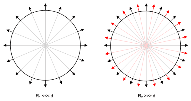

Commensurate with the end-of-chapter questions in Halliday and Resnick, I think the expected argument is qualitative, hand waving and in 2d as is Fig. 27-4.
Construct Gaussian sphere of radius ##R_1<<<d## where ##d## is the separation between charges and enclose the top charge at the center. The electric field lines from the other charge can be ignored because they are much weaker than those form the enclosed charge. The electric field lines emerging from the surface of the sphere are by and large spherically symmetric. If they are not, make the radius smaller until they are. The electric field in any plane intersecting the sphere and containing the charge will have field lines as shown in the figure below left consistent with the idea that where field lines are closer together the field is stronger. As has been noted already, this is a 2d picture and we are looking at the in-plane electric field. The spherical symmetry of the point charge says that there is no "equator" where the lines will be closer together and no z-axis with respect to which spherical angle ##\theta## is defined.
Now construct another Gaussian sphere of radius ##R_2>>>d## (figure below right). Here we also have spherical symmetry but twice as much charge at the center and twice as many lines emerging from the surface. The red field lines from the second charge are interspersed with the black field lines from the first charge. The result is half the angle between field lines at large distances. I don't like this argument but it is what I think the book wants me to say.

A formula relating the two angles ##\theta_1## and ##\theta_2## in the figure of post #8 is $$\theta_2 = \cos^{-1}\left[ \frac{1}{2}(1+\cos\theta_1 )\right]$$
For example, a field line that leaves the upper charge horizontally (##\theta_1 = 90^o##) will end up with ##\theta_2 = 60^o##.
If the angles are expressed in radians and if ##\theta_1## is small, then ##\theta_2 \approx \large \frac{ \theta_1}{\sqrt{2}}##.
