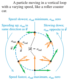

My confusion arises from this diagram. Why atangential = 0 at the top and at the bottom point? Isn't the magnitude of velocity changing at these two points? Why not?
Is there any tangential component of force at the top and at the bottom ?

In the diagram (post #3), tangential acceleration is zero at the top and the bottom. Is this because velocity is minimum and maximum at those two points?
If so, can I say that tangential acceleration is zero when the particle is at it's maximum or minimum speed?
Thank you. I missed that point. Actually I was thinking in terms of velocity.
Still I wonder, if no tangential acceleration (hence tangential force) is acting at the top, and the particle has zero speed, why the particle simply doesn't fall down in a straight line from the top?

So in this diagram, speed is not zero at the top ? (Thanks for your patience!)
Adjoint said:
Oh sorry.
Yes . Speed is not zero .
Then speed is constant there right? (Because atangential = dv/dt is zero there.)
But just before the particle reached the top, it was slowing down and right after it crosses the top, it speeds up... So what does it mean to say speed is constant at the top point?
The speed is not constant anywhere. It has a minimum at the top.
If speed is not constant anywhere (hence not at the top too) how can atangential = dv/dt = 0 at the top?
Tanya Sharma said:
No .
Yes, you can say that. These points are the local extrema of the function Vtan(t). Meaning, the first derivative(i.e., tangential acceleration) is zero at those points.
http://en.wikipedia.org/wiki/Maxima_and_minima
http://en.wikipedia.org/wiki/Critical_point_(mathematics)
http://en.wikipedia.org/wiki/First_derivative_test
Whenever a continuous function changes from increasing to decreasing, or vice versa, it will have a critical point(local maximum or minimum) there.
For example, look at a ballistic trajectory of a rock thrown into the air. Draw a function of height vs time(i.e., y(t) ). It'll be a familiar parabola. As the stone reaches the topmost point, you can see that to the left of that point(i.e., earlier) the height always increases, while to the right it always decreases. This means that the first derivative(velocity, Vy(t) ) is zero exactly at that point.
Remember that when you talk about the value of any function at one particular point, you can't say whether it is constant or not. It makes no sense to say that, as you need an interval to talk about changes. At one point, any function will have just one value.
The stone momentarily stops at the top of its trajectory, and it has 0 velocity in the y direction there, even though the velocity is never constant.
So, back to your circular motion. At the extreme points, the velocity is maximum/minimum, but to tell whether it changes or not you need to look at the whole thing.
