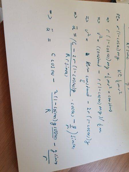

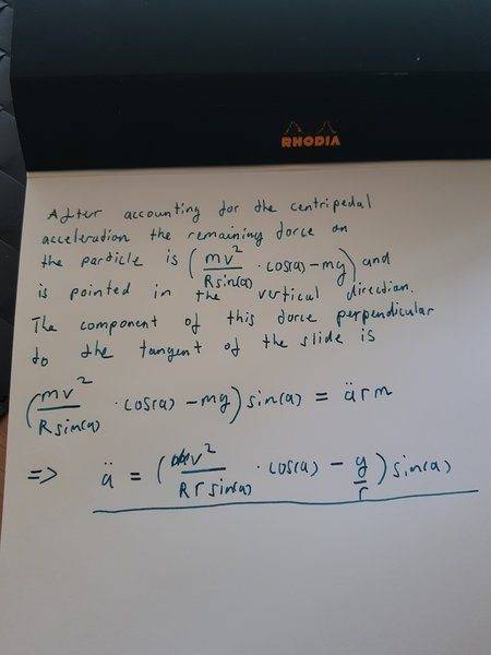

Tangential movement in a waterslide
In summary: It's true that the normal force is always perpendicular to v, but that doesn't mean it can't do work.In summary, the conversation discusses the motion of a person on a waterslide with a fully horizontal curve that has the shape of a circle segment. The question at hand is how to describe the tangential equation of motion for the person's angle in the slide. The conversation also mentions using the small angle approximation for sine and cosine. The attempt at a solution involves finding the centripetal force, the normal force, and the remaining forces acting on the person. However, the equations are not immediately useful and a more accurate approach would be to write the position of the mass in terms of coordinates and differentiate twice to
  • #36
It is question 1d incase I am explaining something wrong and somebody understands german
  • Physik_h16_Aufg-18.pdf
