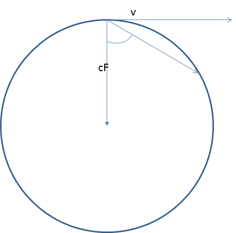

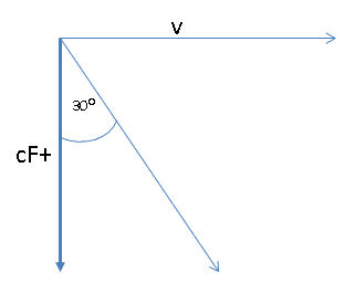

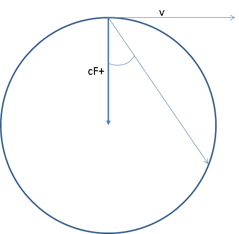

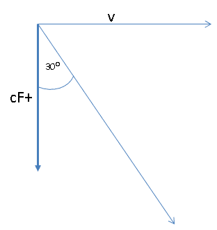

Hi I have a scenario with which I wish to understand .
I have a ball on a string which is in uniform circular rotation at Tangential velocity v
Assume friction is not present
I now increase the centripetal force by pulling on the string from the centre,
what has happened to the tangential velocity ?
I have seen a few posts which says that as the centripetal velocity is perpendicular to the tangential a change in this force will not result in an increase in the tangential velocity.
but intuition tells me that as the ball is forced onto a smaller and smaller radius its rotational speed will increase.
If I thought of this as the components acting upon it - Tangential inertia and Centripetal force then as I increase the force the angle of the resultant vector will decrease .
Doesn't this mean it has a greater rotational velocity ? doesn't that infer greater tangential velocity ?

Your hypothesis is correct. The tangential velocity will increase.
An easy way to derive this is to note that angular momentum is conserved, because pulling on the string cannot impart any torque on the ball. Angular momentum is ##mr^2\omega=mrv## where ##v## is tangential velocity. Given that this remains constant and ##r## is reduced, ##v## will increase.

The force from the string is not perpendicular to velocity when the radius decreases. It has a component parallel to velocity, so it’s doing positive work and increasing the speed of the mass.

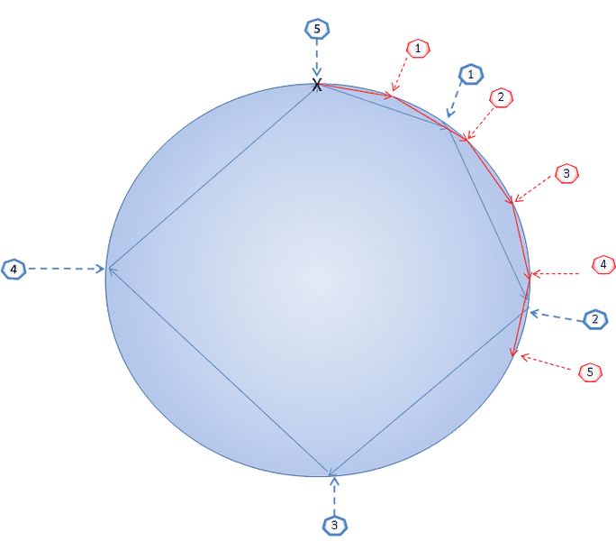

Thanks for all your responses, Thinking about how to frame my question , I believe I can phrase a scenario in terms of something akin to A and B
I have a circular pool table with a red and blue ball, both begin with an equal tangential velocity at point X
The table and the blue ball are so charged so as to cause a weak local repulsion between them, the red ball holds no charge -
As such The red ball receives just enough centripetal force to keep it in uniform circular motion whereas the blue ball encounters a greater force deflecting it continually towards the centre. (My attempt to demonstrate a possible greater centripetal force, please don't get hung up on magnetic fields it is just a proxy example)
As the additional force on the blue ball is constant I could see that the deflection angles will be cumulative from each interaction ( my attempt at resultant force vectors changing ) This causes the ball to travel along a reducing radius r but a larger circumferential difference ω than the red ball . This would agree with our prior example however I have attempted to demonstrate that the Mass distribution hasn't changed by landing the blue ball (after 5 collisions) at the same radius and starting point X to replace the original mass.
Now if we were replicate the balls from a single example to a large enough N I could see that the average distribution of mass has stayed constant but the vectors of momentum have increased tangentially.
What am I missing ?
The maths ... either you have added up wrong or you do not have a static configuration.
I cannot tell because the description is not rigorous enough to pin anything down properly (I'd have to make too many guesses).
I suspect the situation involves some torque, at least temporarily.
For this to happen your force fields must have applied some net torque.
As I understand the pool table example, each bounce by the blue ball involves a radial rebound velocity that is greater than its radial impact velocity. It bounces away faster than it arrived. However, this need not also include any change in what we might call tangential velocity. Accordingly, it need not involve any torque or change in angular momentum. Let us proceed on the assumption that this is the intention, that angular momentum is preserved.
The blue ball will still pass the red ball. But both have the same angular momentum so you might wonder how that could be. The blue ball has a trajectory that carries it closer to the center of the table. Its average angular velocity can be comparatively higher while its angular momentum remains constant. Eventually its trajectory should become a series of close passes by the center, each barely missing to the left. The "centripetal force" required to continue this series of bounces will increase without bound.
But the limiting trajectory is not circular -- it is anything but. So there is no reason to expect a limiting force of ##\frac{mv^2}{r}##

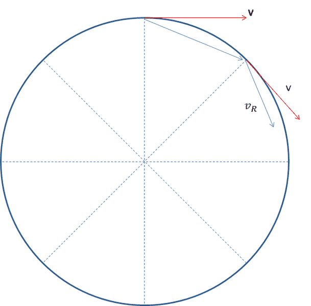

I think I have found a clue to the torque issue -
The attached link discusses how a force acting perpendicular changes the resultant vector such that the resultant vector is no longer perpendicular to the original force.
https://www.physicsforums.com/threa...l-force-change-the-magnitude-of-speed.392768/
"In order for a force to change an object's direction of motion, but not its speed, that force must be always perpendicular to the object's velocity. That's not the case in your example. As soon as the wind acts, it changes the plane's velocity so that it is no longer perpendicular to the force."
If I was to equate that to my red and blue balls this time examining over just an initial interaction and a second resultant interaction
The red ball being in uniform circular motion only ever receives enough centripetal force to continue this orbit as such it always has a vector perpendicular to the axis of rotation causing the centripetal force to always act towards the center -no tangential component of force no torque
The blue ball velocity vector Vr, (when its additional displacement is viewed in terms of its secondary interaction) being the resultant vector of the initial is no longer perpendicular to the centripetal force it experiences . As its velocity vector is no longer perpendicular to centripetal force the force is allowed to have a tangential component - torque is provided .
How did I do ?

Tom79Tom said:
As its velocity vector is no longer perpendicular to centripetal force the force is allowed to have a tangential component?
The term "centripetal" is ambiguous when the path becomes non-circular:
- In the formula above it means: perpendicular to velocity, or towards an instantaneous centre of path curvature at distance r
- You use it as: towards a fixed centre of some circle, which might have been the initial path

Your most recent diagram and explanation were not understandable. It is not clear what you are claiming or why.
What do you mean by a "resultant" interaction? Are you talking about the resulting velocity, the additional force, the net force, the additional velocity or what?
That's a mouthful. Yes, the blue ball has a radial component to its motion. Yes, that means that the motion has a component parallel to the applied central force.
Yes, the speed can increase as a result
No, that does not follow. The increment to velocity is in the radial direction. There is no increment to velocity in the direction perpendicular to radial. No increase in angular momentum and no torque. As has been pointed out, "tangential" is ambiguous here.
