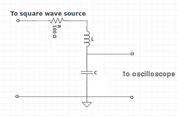

The first image is basically what to expect. When the square-wave transitions there are oscillations in the LC circuit. Your square wave shows a sharper rise than its fall, so the tank oscillation should be more pronounced on that rise than the fall. (Remember, I said they won't be discernible until you stretch the waveform out horizontally because of their much higher frequency.)
The mains hum on your signals needs to be eliminated, and it's probably an earthing problem. What are you doing with the black Earth clips on your oscilloscope probes? They should be earthed to the signal generator earth, along with part of the tank.
Try this series LC arrangement with the oscilloscope connected across the capacitor. It won't show ringing, the resistor gives too much damping, but at least it will show whether you are able to get rid of the mains hum. (If the hum can be cleaned up, try shorting out that 100 Ohm resistor and see how the waveform changes.)
I'm going to have give more thought to how the parallel arrangement can demonstrate its ringing.

For the inductor, the few turns you are using store very little energy; to get a ringing display like you expected to see I think you will end up having to use a much larger inductor.
The scope's setting for voltage/div greatly affects the amplified frequency.
You will have to explain what we are to understand by your phrase "amplified frequency".
Why not use a higher inductance and aim at a lower resonant frequency (is the actual frequency important for your exercise?)? Also, if you want to obtain a better Q factor for your resonator you could consider feeding it via a 'tap' on the inductor - say across the bottom few turns (as in an auto-transformer) or across a large value C (Ten times the resonator C) placed in series with L and C. Damping due to the sig generator will be a lot less of a problem with this arrangement.
