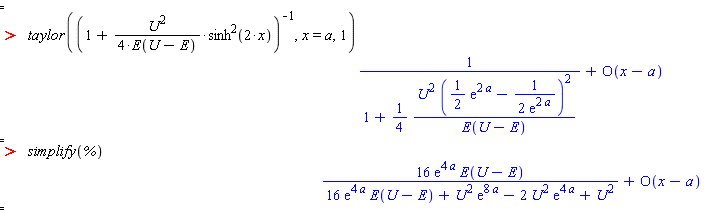

I am horrible with taylor approximations and sometimes am not even sure when to use them (hence the "I think" in the subject).
I would assume that we are approximating due to the question. I would also assume that because of that, we want to taylor expand. I didn't try this by hand, but I did put it into Maple and it said that there wasn't a taylor expansion for this particular item.
Am I approaching it correctly? Taylor expansions and when to use them are my goal between spring and summer semester, that's for sure. :biggrin:
Okay I lied. I tried the expansion again from 1 to 1 instead of 0 to 1. This got me closer, assuming I am doing it right. Except my α term is gone now.
[tex] T=\frac{16(e^{2L})^{2}E(U_{0}-E)}{(1+U_{0}^{2})((e^{2L})^{2}-1)^{2}}[/tex]
With a term involving what looks like the letter O. I've never used Maple to do these, so I'm not familiar with that term.
It looks like if I multiply that all out, I might have something. With the exception of my missing α terms.EDIT: I mistyped this into maple so the solution isn't right. I corrected it, but now I'm not even close. So I have to be doing something drastically long.
Oh...I also expanded over α.
I tried simplifying it and got close but can't quite get there. Not to mention I am missing the α term I need.

Ok. I've tried and tried approximate this thing, but I am still not getting anywhere. I've attached my latest attempt in Maple. It's close, but not quite there.
What do you guys think?
