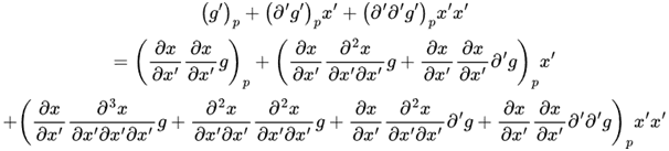

Trouble following sketch proof !
Carroll expands both sides of metric transformation (Notes eq2.35, Book eq2.48)
to equate powers of x’.
He starts with eq2.36 (2.49):
So far so good, though I feel my understanding of multivariable Taylor series starting to struggle.
He refers to Schutz for details, where I find eq 6.23:
It seems to me that applying
to 2.36 should give a version of 6.23, but the constant coefficients seem offset?
Then the left hand side of Carroll 2.37 agrees with Schutz 6.24, but trying to understand the right hand side, I find Schutz 6.26 with too many indices and Carroll 2.37 too few, for me to follow.
The presence of partial derivatives of g imply some application of the product rule which I don’t understand, when (I presume) substituting the two Taylor expansions. Or am I completely off-piste? :-)

Yes, I 'translated' the Schutz.The coefficient offset arises when:
which would give coefficient 1/2 to the single power of ##x^{\mu'}## whereas Schutz 6.23 has 1/2 on the second power?Also, I thought ##g^{'}_{\mu\nu}\left( x' \right)## would imply ##g_{\mu\nu}\left( x \right)##,and so the latter would not need expansion in x' ?

strangerep said:
Thus, in your notation, i.e., ##g'_{\mu\nu}(x' )## should be interpreted to mean "transform not only the components of the tensor ##g##, but also the variable on which it depends".
Ah, right. The LHS is a simple Taylor expansion, whereas the RHS is the product of expansions of 3 transformations. I got lost figuring out exactly what needed transforming :-) Thanks again.

Apologies for my simplistic struggles, but:
Carroll (book) 2.50, left side is
##(g_{\hat{\mu}{\hat{\nu}}}=) \left( \hat g \right)_{p}+\left( \hat{\partial } \hat{g}\right)_{p}\hat{x}+\left( \hat{\partial}\hat{\partial}\hat{g} \right)_{p}\hat{x}\hat{x}+##
which I take to be an expansion of ##g_{\hat{\mu}{\hat{\nu}}}\left( x^{\hat{\alpha}} \right)## in terms of ##x^{\hat{\alpha}}##, with no transformations.
Filling in the indices, I get
##g_{\hat{\mu}{\hat{\nu}}}=\left( g_{\hat{\mu}{\hat{\nu}}} \right)_{p}+\left( \frac{\partial }{\partial x^{\hat{\alpha}}} g_{\hat{\mu}{\hat{\nu}}}\right)_{p}x^{\hat{\alpha}}+\left( \frac{\partial ^{2}}{\partial x^{\hat{\alpha}}\partial x^{\hat{\beta}}}g_{\hat{\mu}{\hat{\nu}}}\right)_{p}x^{\hat{\alpha}}x^{\hat{\beta}}+##
but cannot see where the expected coefficient of 1/2 for the third term of a Taylor expansion has gone to.

Hmm. Neither can I. The ##\frac12## is missing from the 2nd-order term on both sides of (2.50).
I think what's going on is this: Carroll only needs the number of terms at each order, but doesn't need the multiplicative factors. [Read the paragraph following (2.50) to see this.] If he restored the ##\frac12## on both sides it wouldn't change the argument in that paragraph.
