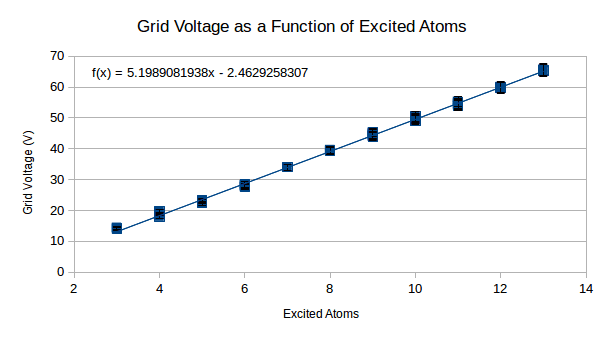

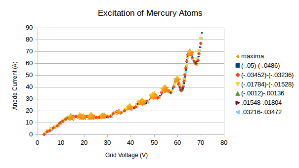

Basically, I have recorded data,
where the stars are the position of local maximum used in determining the period of atom excitation. Plotting the local maximum as a function of integers yields this graph,
to which the residual plot for linear regression looks like
. As you can see on the residual plot, the precision of the later data points is much less pronounced which makes me somewhat uneasy. Basically, I am trying to figure out what the error bars associated with the residual plot should be. Right now, they're just a constant 3% of the voltage reading.
As for the current measurements, a cord, I am amusing a probe, was connected directly from the 3B Scientific™ Power Supply Unit for Franck-Hertz to the oscilloscope. I think the probe specifications can be found on page 137 (page 115 of the actual manual) http://inpp.ohiou.edu/~roche/3701_web/tektronix-tds.pdf. With this being said, I am not sure what this information means or how to use it to find accuracy of current readings. Additionally, the specs for the PSU can be found here: https://www.fishersci.com/shop/products/3b-scientific-power-supply-unit-franck-hertz-experiment-115v-3/p-4085788#tab2 and "Output A for collector current I: I = UA ™ 7nA/V (0 to 12V)." maybe be of some importance though I am unsure.
