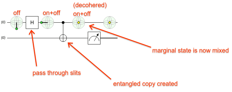

Even in the ideal case, the detectors create an entangled copy of information defining the light's position. This counts as an interaction.
(The detector also amplifies the entangled copy of the information into a full-blown thermodynamically-irreversible measurement.)
Here's a diagram of a circuit showing the effects of the operations on the state:
Screenshot from 2016-04-04 17:43:14.png
The top wire represents the position of the photon (which slit it went through). The bottom wire represents the detector state. Both can be in two states, which we call Off and On or equivalently ##|0\rangle## and ##|1\rangle##.
Going through the slit is emulated by a Hadamard gate, which changes the top wire's state from ##|0\rangle## to ##\frac 1 {\sqrt 2} |0\rangle + \frac 1 {\sqrt 2} |1\rangle##. The position state is in superposition.
The detector is emulated by a Controlled-Not gate. It copies the position information onto the second wire, but the copy is entangled not independent. The system ends up in the state ##\frac{1}{\sqrt{2}} |00\rangle + \frac{1}{\sqrt{2}} |11\rangle##. This is observationally distinguishable from the previous state, using only the first qubit, because the density matrix you get when you trace out the second qubit has gone from ##\frac 1 2 \begin{bmatrix} 1&1\\1&1 \end{bmatrix}## to ##\frac 1 2 \begin{bmatrix} 1&0\\0&1 \end{bmatrix}##.
The result is that the qubit no longer self-interferes when you rotate it; it's stuck in the ##\frac 1 2 \begin{bmatrix} 1&0\\0&1 \end{bmatrix}## state at the center of the Bloch sphere. In practice that shows up as the interference pattern disappearing.

I really appreciate your writing everything out the way you did. Finding it very difficult, I read it four or five times. I hope you'll indulge a couple questions I have even if those questions end up demonstrating nothing other than my remarkable ignorance of the matter.
Would it be fair to say that implied in these words is the observation that, whether speaking of the photon or the entangled copy, the measurement involved a transfer of energy, i.e. the way energy is transferred when a photon is absorbed?
This observationally distinguishable change in the state of the system, does it correspond to a change in the state of an electron having taken place? If so, where? Somewhere in the detector? Or does it have nothing to do with an electron changing state?
Another question... I'm unclear, is the detector actually in the path of the photon? I figured it was kind of off to the side, like an audience member watching a tennis match. But now I wonder if that's wrong. Is the photon directed at the detector which reflects the light to the back plate at the same time as detecting it?

No, that's not implied.
In quantum mechanics, energy is a complicated concept related to the eigenvalues of a matrix that defines how the system as a whole changes over time. It may not be associated with individual parts of the system. I recommend focusing on the information instead of the energy.
Quantum information can be embodied in many different ways, but it follows the same rules regardless. Whether it's the spin of an electron or the polarization of a photon isn't really relevant. What's relevant is the fact that there's a copy; that the system as a whole went from ##|00\rangle + |01\rangle## to ##|00\rangle + |11\rangle##.
When you ignore the system as a whole, and focus on just one of the parts, some of the picture can be missing. Before the photon has hit the detector, you wouldn't be missing any of the picture by ignoring the detector. Afterwards, you are. That's the difference.
DavidReishi said:
Another question... I'm unclear, is the detector actually in the path of the photon? I figured it was kind of off to the side, like an audience member watching a tennis match. But now I wonder if that's wrong. Is the photon directed at the detector which reflectsthe light to the back plate?
Yes, it's actually in the path of the photon. But the detector doesn't have to reflect the photon. For example, the detector could work by passing the photon through an SPDC crystal and directing one of the resulting two entangled photons into a photomultiplier. That will lower the frequency of the photon, and make its path deviate a bit, but otherwise leaves it unmolested.
In the ideal case there's no interaction at all except for the creation of an entangled copy.
