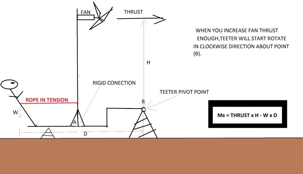

this is my half weird teeter with pivot point at (B)
and we have two solution for conection ,rigid conection and with universal joint..
this is example how type of conection can change direction of rotation..
basics question is :in what direction will teeter rotate about pivot point (B)..
rigid conection
universal joint conection
Do you agree with my conclusion and moment equation?

Why is the rope not in tension in the first case?
As for your argument: Make sure you have the directions and magnitudes of the forces on the teeter by feet and UJ right. Draw a diagram where they are shown.

I forgot to write,but rope is in tension,I add it now...
rope is 100% horizontal so at men feet is all men weight(W),horizontal forces " rope tension" at feet and U.J. cancel each other out,so we have Thrust and W..so rotation is in counter clockwise direction,but ground will stop this rotation...
Do you agree with me that teeter with U.J. case have tendency to rotate about point B in counter clockwise direction,opposite from case with rigid conection?that is idea of this experiment,so we change direction of rotation with different type of conection?So if we put weight scale below teeter ,when we increase fan Thrust ,weight scale will increase weight numbers..

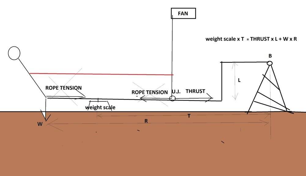

You have drawn two forces at UJ. Which one is acting on the teeter?
Assume the propeller mast is massless, so forces and moments on it have to balance. Does your solution satisfy this condition, for arbitary rope height to mast height ratios?
Dont understnad your question..
Yes this is internal forces at U.J. one is from rope tension ,one is from fan thrust..
Yes men is in balance with propeler mast..

What is the direction of the force by the mast on the teeter?
You are trying to draw conclusions about how the scale reading will change when you turn the fan on or off.
But turning the fan on or off is not the only change you have to make. When you turn it on, the fellow on the teeter has to lean back. When you turn it off, the fellow on the teeter has to return to a vertical posture.
to the left,
sum of horizontal forces at feet and u.j. is equal to thrust with direction to the right..

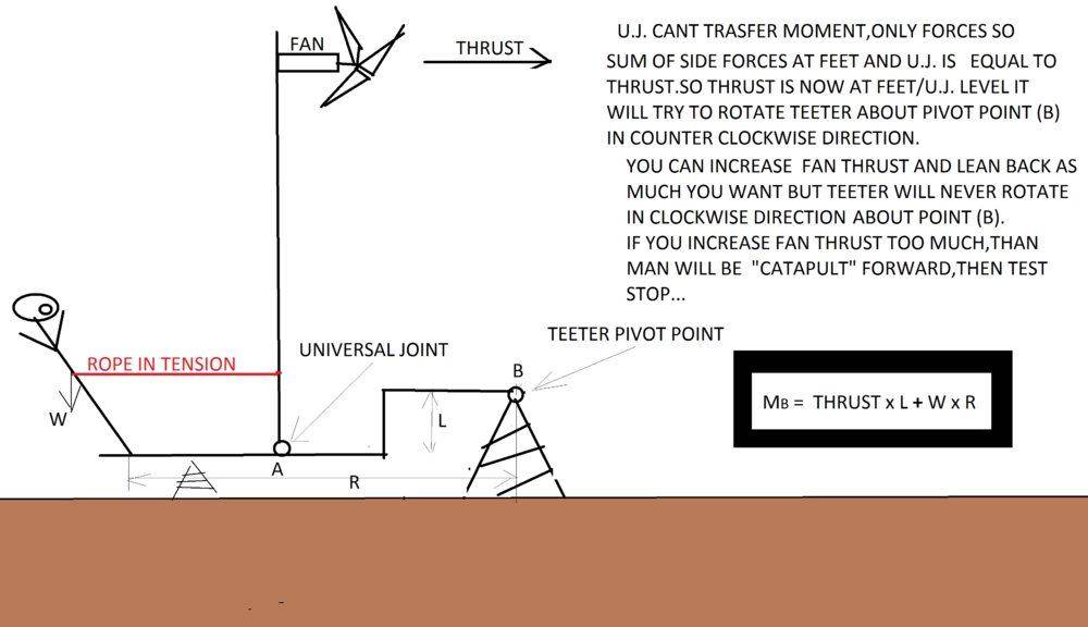

I just want to prove that in case of U.J. conection you can not rotate teeter in clockwise direction about teeter pivot point B, whatever you do with fan thrust or with your body position.
Isnt it obvious with just one look at the picture?

I just want to say next:
1) for rigid conection ; if , Thrust x H > W x D ,teeter will rotate clockwise,(so with fan thrust you can rotate teeter clocwise)
2)for U.J. conection: when you turn ON fan, teeter will try rotate conuter clockwise,it will push at the ground,so if you put weight scale below teeter ,weight scale will increase reading,
but assumptions are that feet do not slip and men and mast of fan is in balance,(so when fan is turn ON and men and mast is in balance,teeter has counter clockwise torque)
so with different conection we change teeter direction of rotation,yes it sounds very weird,but that's the way it is
(but normaly if you increase fan thrust too much ,that will slide or bring down men to the right,mast will come in contact with teeter construction and teeter will agian rotate clockwise,but then men and mast is not in balance,so my assumption is violated)

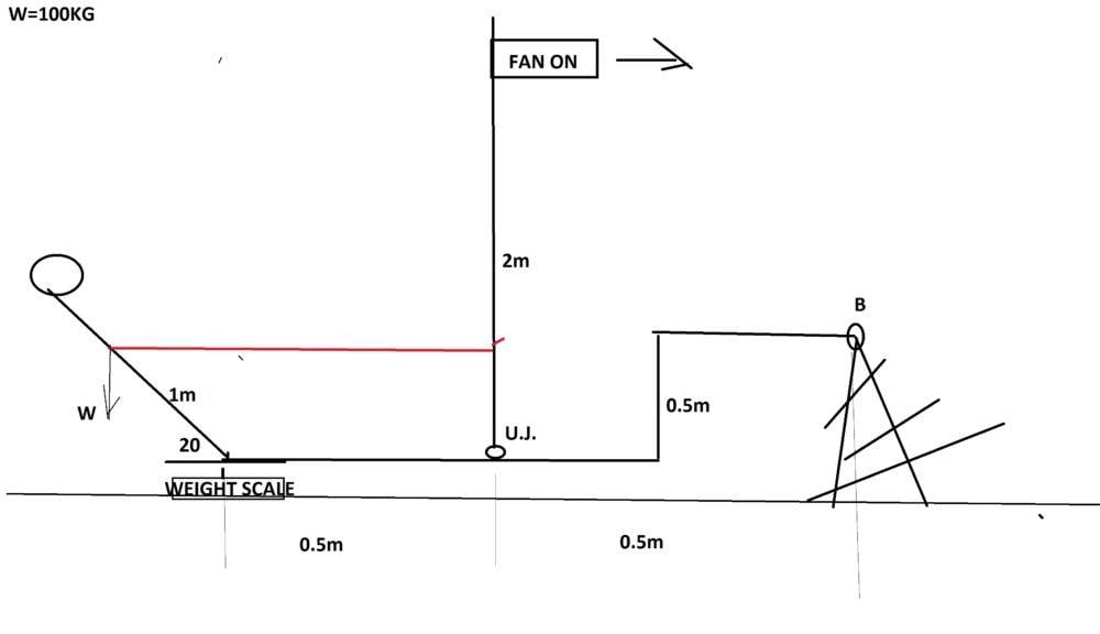

rigid conection
calculation for minimum thrust force for teeter rotation :
thrust x 1.5m > 100kg x 1.93m... thrust=128kg ...so if thrust is equal or bigger than 128kg than teeter will rotate in clockwise direction...than weight scale= 0kg
u.j.conection
calculate tension in rope:
100kgxcos20=Txsin20
T=274kg
calculate Thrust force
274kgxsin20=Thrustx2m
Thrust=46kg
(men can not achive 128kg of thrust force,becuse it will be slide or bring down"catapult" to the right,maximum theoretical thrust that men can achieve with U.J. case is 50kg)
calcualte weight on scale
weight scale=Thrustx0.5m + Wx1m=46kgx0.5 + 100x1m
weight scale=123kg

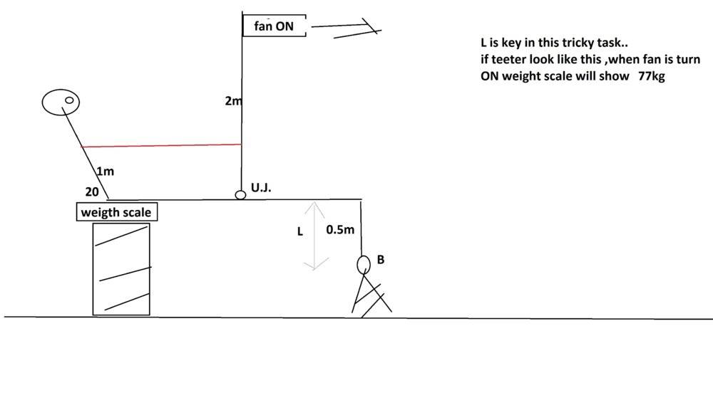

differnet teeter desing

Not really. I was forced to reverse engineer your reasoning process by looking at the numbers in your equations.
As I understand it, your point was to deduce that
1. 128 kg thrust is required to balance the teeter.
2. The man cannot counterbalance 128 kg thrust even if he leans back at 20 degrees from the horizontal
3. For a fixed thrust, the higher the teeter is raised over the pivot point, the less clockwise torque is required to support it against tipping left.
I agree with all three points.
Let me try to show your work...
You begin with a calculation for the "rigid connection" case. No drawing is supplied. However, the first drawing with the universal joint replaced with a fixed joint would be apt.
You appear to have a 2 meter mast, a man that is perched 1.93 meters to the left of the pivot point and a teeter that is depressed 0.5 meters below the pivot point. The 1.93 meter displacement is because the man is leaning back at an steep angle, making 20 degrees from the horizontal. The man's feet are 1 meter left from the pivot and his center of gravity is 1 meter away on the diagonal. The cosine of 20 degrees is 0.93.
You equate the torque from the man (100 kg * 1.93 meters counterclockwise) with the torque from the fan (thrust * 1.5 meters clockwise) to deduce that the two balance when thrust is 128 kg.
If you'd done the calculation more accurately, you'd have gotten 129 kg.
rigid conection
Now you draw the same scenario, this time with a universal joint
u.j.conection
Again the 100 kg man is leaning back at a steep angle so that he makes 20 degrees from the horizontal. Because the mast is free to swivel, this constrains the thrust that the fan must make. You proceed to calculate that.
You equate torques about the man's feet. His weight times the horizontal displacement of his center of gravity from his feet is equal to the rope tension times the vertical attachment point of the rope.
You've skipped the step where the man's height cancels out of the equation by making an unstated assumption: The rope is attached at the man's center of gravity.
100kgxcos20=Txsin20
T=274kg
Let us check the numbers. Tension = 100 kg times the cotangent of 20 degrees = 274 kg. Check.
Now you proceed to calculate the thrust of the fan.
Now you work with torques about the universal joint. It seems that the 1m on the drawing is the height of the man's center of gravity when standing vertically. Since he is leaning back at a very sharp angle, the vertical height of that center of gravity is much reduced. The rope is apparently supposed to be horizontal. [Perhaps it is greased and is free to slide up and down the mast].
You equate the counter-clockwise torque from the rope tension with the clockwise torque from the fan:
Thrust=46kg
Checking those figures, it seems that you have rounded 46.8 down to 46. A better figure would be 47 kg.
You proceed to make a comment that seems to relate to the force of static friction. That the man cannot lean back any farther without his feet sliding out from under. So he is limited to balancing a thrust of about 50 kg (apparently rounding your computed 46 kg up to 50 kg).
Yes, I agree with all of this so far.
You proceed to calculate the displayed weight on the scale. This time you are equating torques about the pivot point of the teeter.
The net horizontal component of the external force of man and mast on the teeter has to match the external force from the fan. Both components of that force (from the man's feet and from the universal joint at the bottom of the mast) are 0.5 meters below the pivot point. So that's a counter-clockwise torque of thrust * 0.5 m.
The net vertical force on the teeter has to match the weight of the man. The man's weight is 100 kg force and this force is applied to the teeter at the man's feet. [The mast can exert no vertical force since it is massless, since the rope is horizontal and since the fan thrust is horizontal]
weight scale=123kg
Yes, I agree.
You then proceed to shift whole assembly to 0.5 m above the pivot point, giving the 46 kg fan thrust an extra 1 meter of moment arm and note that the weight scale reading is reduced by 46 kg.
Yes, I agree.

So with that rule applaying on our case we can see that "thrust" force "act" in level of U.J., so now "thrust" is 0.5m below pivot point B ,so it make counter clockwise rotation..
(50kg max thrust is not rounding 46 number, I just want to say that this is maximum theoretical thrust when men lean angle is zero degrees(horizontal) so 100kg x 1m =Thrust x 2m...Thrust =50kg but this is irrelevant for our case ,,maybe I shouldn't have mentioned it, too messy already)
OK, now I understand that. It is like hiking out from a sailing boat. You are limited by the length of your legs.
Yes.
My case with U.J. is very not intuitive/confusing because real external force Thrust at fan is 1,5m above pivot point B but teeter do not rotate clockwise as many would assume at first glance...
