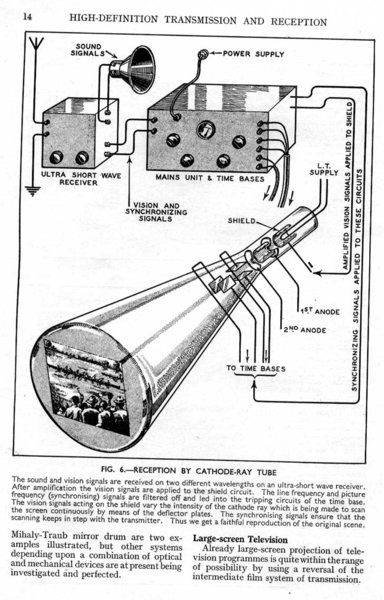

I was surfing the net to get some ideas involving the Kerr electro-optic effect and noticed this Wikipedia external link.
It's page two from Television History - The First 75 Years. It has some cool old articles and pictures like these (images can be made larger in your browser):
Just thought I share.

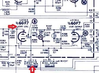

Wow . what the old timers did is remarkable.
When was the last time you saw Vertical and Horizontal Hold knobs on a TV ? I think my RCA CTC19 was the last set i owned with them. Schematic starts page 3 here: http://www.americanradiohistory.com/Archive-Radio-Retailing/60s/Electronic-Technician-1966-02.pdf
From Wiipedia
Horizontal hold and vertical hold
The lack of precision timing components in early television receivers meant that the timebase circuits occasionally needed manual adjustment. If their free-run frequencies were too far from the actual line and field rates, the circuits would not be able to follow the incoming sync signals. Loss of horizontal synchronization usually resulted in an unwatchable picture; loss of vertical synchronization would produce an image rolling up or down the screen.
The adjustment took the form of horizontal hold and vertical hold controls, usually on the front panel along with other common controls. These adjusted the free-run frequencies of the corresponding timebase oscillators.
By the early 1980s the efficacy of the synchronization circuits, plus the inherent stability of the sets' oscillators, had been improved to the point where these controls were no longer necessary.
ahhhh yes, i remember it well,,,

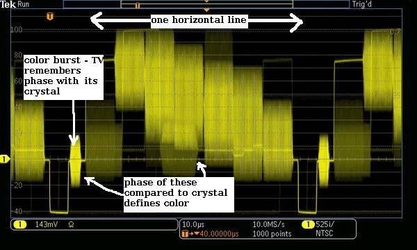

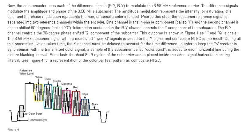

I don't remember the nitty gritty details, never really got deep into TV.
I was astonnished when i read how the color got basically just tacked on top of the B&W signal ...
from https://www.extron.com/company/article.aspx?id=ntscdb1d
3.58 mhz color carrier is actually 3.579545 mhz so as to not be a harmonic of 60 hz line frequency.
It needs to be stable enough over duration of one horizontal sweep for phase comparison to convey the desired color. So every NTSC color TV had a 3.58 mhz crystal in it. They were prized for early digital clock time bases , several outfits made 17 stage divider IC's to produce accurate 60 hz for hobbyist clock kits..
https://www.elmelectronics.com/wp-content/uploads/2016/07/ELM440DS.pdfand from https://www.tek.com/datasheet/mixed-domain-oscilloscopes
All that with vacuum tubes ! They were geniuses...
