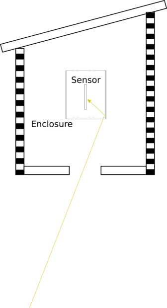

Hello I have a digital thermometer that I put into a wooden enclosure. It has horizontal holes drilled into its sides all around to let air in. On the bottom there is an opening around 1/3 of the width, like in attached photo.
And I was thinking about certain thing. When I put a bare thermometer circuit board in the middle of the enclosure, like on the left side of the attached image, I get certain values. But sometimes sunlight can get through the holes (at sunset) so I decided to put a PVC square pipe around the sensor.
Sensor is attached inside the pipe with two plastic spacers and it's exactly in the middle of the pipe. It doesn't have top and bottom sides. It hangs from the wire in both cases (with or without PVC pipe) from the top of the wooden enclosure.
I noticed that my temperatures are about 0.3 to 0.5 degrees higher with PVC pipe around the sensor than without it. At first I thought that maybe light is getting reflected like in second attached photo,
so I taped the inside with black tape. Still same thing.
Then I though that maybe PVC pipe is warmed up with my hands and with sunlight before I put it inside, but that seemed to be wrong when I stored the PVC pipe inside the wooden weather enclosure, so it should be the same temperature as the enclosure.
So now I'm thinking that maybe ambient air is colder than either wooden enclosure or the PVC pipe, but because PVC pipe is a lot closer to the sensor than wooden enclosure, it could be heating it up those 0.3-0.5 degrees. Any ideas on what's happening here?
Maybe I'm naive, but I thought when something is in (not total) shade and you put it in additional shade it should only get colder, closer to being at ambient air temperature, not hotter.

This is pretty much Stevenson screen, just simlified version of it. With holes instead of angled pieces of wood. I've built real Stevenson screens before, but it's a lot of work.
But that's not important. I am wondering what's going on here, when I have an object in the shade that apparently gets warmer when I put another shade around it.

Welcome to the "wonderful world" of attempts at non-equilibrium temperature measurement; frosted windshields at "above freezing" ambient/air temperature are quite common, as are "opposite" effects such as you've noticed.
You might check for radiation/radiant heat sources in the immediate vicinity; anything within one to two hundred yards/meters is "integrated" into the thermal background. Station locations are "required" to be "unobstructed" to be certified by the NWS; very few actually are.
Hmm... Maybe that's why 'official' weather station enclosure have louvers instead of drilled holes. Put a light bulb in place of the thermometer and notice how much of the surroundings are illuminated; that's what the thermometer sees.

yes, of course. But in that case, what is that additional pvc enclosure doing to raise the temperature? From physics point of view? Is it, in some, way higher in temperature than ambient air so that it heats up the sensor?
I would imagine that if thermometer "sees" through the holes, it would be even better now with something that blocks the way.

It's MPC9808 IC on a circuit board and I'm communicating via I2C protocol with it to a microcontroller outside the enclosure.
I looked at the data sheet. It seems possible that you are 'auto-heating' - power dissipated by the device (And pull-ups, etc.) are warming the temp sensor/PCB when you place it in a 'confined' space.

It's possible. The thermometer is placed on an "island" on the board with only thin bridges that carry power and data, so the heating should be minimal, but I guess it's possible.
I have a (non-functioning) acurite home weather station. It has a small PV panel which drives a small fan when there's sunshine. That is an easy solution to measuring the surrounding air temperature rather than the temperature of static / warmed up air inside the enclosure. Technology beyond Stevenson.

Even better. I'm making 2 more sensors and I will place them inside at the same time, one bare pcb for reference and put the other one in various situations to see what affects the temperature in which way.

How about a solar powered fan at the top of the box. Since the temp variations seem to be most severe in daylight hours, the fan should draw enough ambient air to improve accuracy. The solar powered fan would not add to the heat load inside the enclosure.

The fan only needs to be running during full sun. Let the Sun tell it when to run by using a tiny separate cell to power the fan.

SInce the chip itself is specified as ±0.5°C (±0.9°F), I'm wondering how you will calibrate to ±0.1°C (±0.18°F).
https://www.google.com/url?q=https://ww1.microchip.com/downloads/en/DeviceDoc/25095A.pdf
•Accuracy:
- ±0.25 (typical) from -40°C to +125°C
- ±0.5°C (maximum) from -20°C to 100°C
- ±1°C (maximum) from -40°C to +125°C
