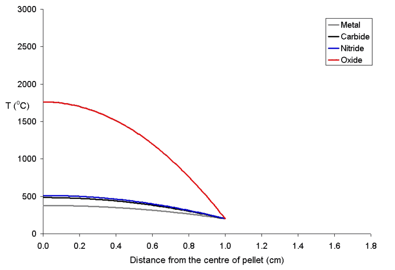

Hi,
As some of you may know, the temperature profile inside a pellet is determined by using the equation given below,
Tx=TRim+ρ(rpellet2-x2)(4Kf)-1
Where;
ρ is power density.
Kf is thermal conductivity.
The temperature profile is strictly dependent on the material used as a fuel. The figure given below shows this dependency,
Here, the fuel pellet diameter, rpellet is 20 mm, and ρ is 250 W/cm^3.
What I want to know is that how the temperatures are different for each material at the center of the fuel pellet since the amount of the fission energy produced inside a fuel pellet depends only on which fuel (U-235, U-238, e.t.c.) is used. Different materials can cause different temperature profiles due to having different thermal conductivity, but I do not understand how temperatures are different at the center.
Maybe I am missing something. Any comments would be appreciated.
The key us that you have a constant power source, rather than a constant temperature source such as a flame within the cylindrical pellet.
Take a look at the diagram of temperature profile once more.
For the metal, a good conductor, heat can flow readily from the interior to the exterior.
For the oxide, a poor conductor, heat does not flow as readily.
What does that tell you what should happen to the temperature in the interior.
It isn't an issue with what isotopes fission, it is an issue with the thermal conductivity of the material (metal, nitride, oxide, etc.).
Each of these materials have different thermal conductivities.
The metal has the highest thermal conductivity, so the heat will transport through a metal the easiest, and the peak temperature will be lower.
Oxides have a lower thermal conductivity, so the heat will transport less easily, and the peak temperatures will be higher.
If the physics doesn't make sense, look at the math. If you increase the thermal conductivity (Kf), it will lower the quantity on the right hand side, which will decrease the temperature. If you decrease the thermal conductivity, it will raise the quantity on the right and increase the temperature.

I felt that it was related to thermal conductivity. However, I expected the temperature at the center was the same for all materials while there is a rapid temperature drop for a material that has a high thermal conductivity.
The equation given above manifests the temperature profile as it is given in the graph. However, I am not somehow satisfied.
Any more comment would be appreciated.
Likes drvrm
Why would you expect that?
The volumetric heat generation rate is same for all materials. Am I thinking wrong?
well that's right. But at steady state, all of the heat generated has to be leaving the pellet, right? What determines that? How does the heat generated at radius r get out to the edge?
