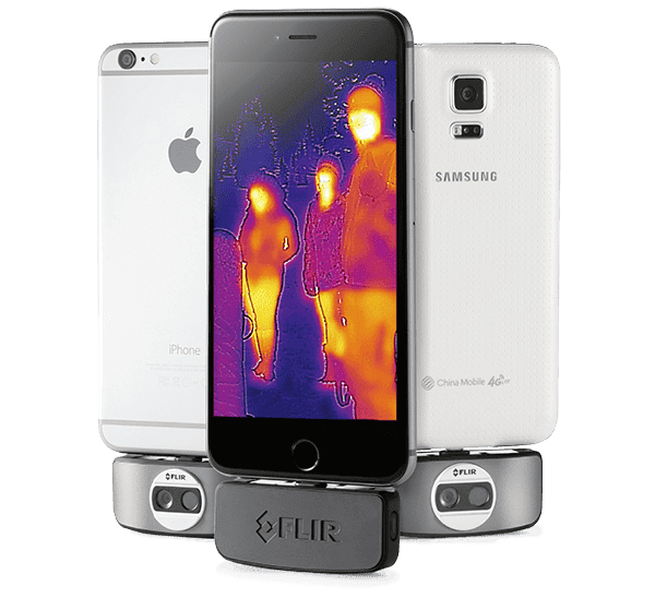

There are IR camera attachments for cellphones that may do what you want:
http://www.flir.com/uploadedImages/FLIR_ONE/Buy/FLIR-ONE-iOS-Android.png
Dear Mr. Berkman,
The writer is a professional IR thermographer LVl II and well under stood
the system and operations using many models of the camera from Flir.
