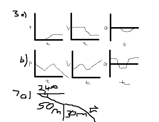

See attachment, it is the question sheet.

3. See attachment with no title.

7. See attachment

I didn't find you solution for #7.

in #7 you can break up the components of in xy-axis format. The car is in linear motion up to the edge of the cliff so what parameter can be calculated for the vehicle at this point(end of cliff). take this parameter and break it into its x and y components and find the horizontal displacement seeing as you have the y displacement and use pathagoras to get the relative position. from here time could be calculated as well as final velocity, remember to give an angle to this as it is a vector. keep in mind, what is the vertical and horizontal acceleration of the vehicle after it left the cliff?
