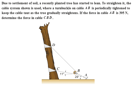

Due to settlement of soil, a recently planted tree has started to lean. To straighten it, the cable system shown is used, where a turnbuckle on cable AB is periodically tightened to keep the cable taut as the tree gradually straightens. If the force in cable AB is 395 N, determine the force in cable CBD.
(see attached diagram)

*hint* A FBD of the pulley at B is recommended to begin this problem. Isolating pulley B from its surrounding requires a closed surface passing through cables AB and BCD (along both segments BC and BD). The problem has a symmetry that becomes apparent with an orthogonal coordinate system having one axis aligned with AB.

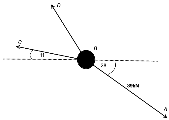

Ok but that still doesn't help me with solving for the force in CBD. Can someone walk me through the steps please?
Did you draw a FBD for the pulley? What forces act on it? What are their directions?
I just attached a FBD of the pulley but it doesn't really help much. I don't know any of the angles for BD so I don't know how to account for the forces with it.
Your FBD looks good. Continue with the *hint* regarding how to orient your coordinate system for your FBD.
Ok so AB bisects angle CBD. If you make AB the x-axis CB and DB will be 28-11=17 degrees above and below the x-axis. The two x-component of the two will add up to 395 so the x component of one of them is 395/2=197.5. So the tension is 197.5/cos(17)=207N.
